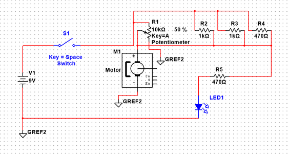

Step 1: Circuitry
  • Begin by assembling the circuit.  What continues will be the description of how to create the circuit using a breadboard.  Assuming you are privy to using the other methods, assemble the electric circuit from the circuit diagram.
  • To do so, insert the components into the breadboard as depicted in the picture.  While it is possible to do some creative wiring, it is highly recommended to exactly copy the circuit from the pictures (both the final circuit and circuit diagram).  To insert components into the breadboard firmly insert the lead of the components into the board.
  • NOTE* The orientation of the LED matters.  The longer end of the LED represents the positive end and the shorter represents the negative end.  Ensure that the flow of electricity travels from positive to negative, failure to do so could result in a faulty circuit.
  • The Circuit Schematic shown can help you find where everything is wired and make sure you have the right values for resistors so use it while assembling the circuit.

  • Once you are certain the circuit is completed, it is time to verify that the circuit works as intended.  Therefore, insert the 9V battery into its housing.  Once that is done, the circuit should still remain off, as in the motor should not move nor should the LED turn on.  Now, flip the switch on the circuit, now the LED should turn on.  The motor may or may not move depending on the position of the potentiometer.  Vary the position of the potentiometer and verify that the motor is speeding up/slowing down.  If you cannot tell, it is helpful to add a strip of tape to the shaft of the motor.  Also, the sound of the motor can help in determining the RPM of the motor.
  • If the circuit works as intended, Congratulations, you may move on to the next portion of the blender.
