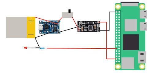

Step 6: Solder Electronics
  1. Prepare Tools and Wires
  2. Plug in the soldering iron and allow it to fully heat up. While waiting, use a wire stripper to strip the ends of all jumper wires that will be soldered into the modules or switch.
  3. Connect the Battery to the Battery Charger
  4. Connect the battery’s positive (+) wire to the B+ pad on the battery charger. Connect the battery’s negative (–) wire to the B– pad.
  5. Connect Battery Charger Output to Slide Switch
  6. Solder the OUT+ pad of the battery charger to one side of the slide switch. The OUT– pad will serve as the ground for the entire system.
  7. Connect the Slide Switch to the Boost Converter
  8. Solder the other side of the slide switch to the IN+ pad of the boost converter. Then solder the OUT– pad from the battery charger to the IN– pad on the boost converter.
  9. Connect Boost Converter Output to Raspberry Pi
  10. Solder the OUT+ pad on the boost converter to the Raspberry Pi’s 5V pin (GPIO Pin 2 or Pin 4). Solder the OUT– pad on the boost converter to any GND pin on the Pi (GPIO Pin 6 or Pin 9).
  11. Important: Before connecting to the Pi, use a multimeter to adjust the boost converter’s output to exactly 5.0–5.1V by carefully turning the small screw on the module.
  12. Connect the LED Indicator to GPIO 17
  13. Connect the cathode (shorter leg) of the LED to any GND pin on the Pi. Connect the anode (longer leg) to one end of a 220Ω resistor, and the other end of the resistor to GPIO 17 (Pin 11 on the Pi). This allows the Raspberry Pi to control the LED via code.
  14. Insulate and Check Continuity
  15. Cover every exposed solder joint with electrical tape, especially around the switch, to prevent short circuits. Use the multimeter in continuity mode to test all key connections. Ensure that grounds are shared across all modules and that there are no shorts between power and ground lines.
  16. Final Check
  17. Double-check that all wires are secure and insulated. Confirm the boost converter is outputting 5V. Flip the switch to ON — the Raspberry Pi should power up safely.
