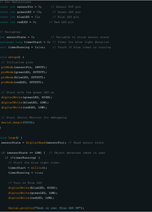

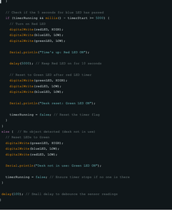

Step 4: Coding
Write the code to control the lights and timer:
The green LED will always be on, indicating that the desk is available for use.
When the avoidance sensor detects someone sitting down, the blue LED will turn on, indicating the desk is in use.
After 5 seconds (for testing purposes), the red LED will turn on, signaling that the study session is over.
Timer logic: Set up the timer to count 30 minutes for the study session.
