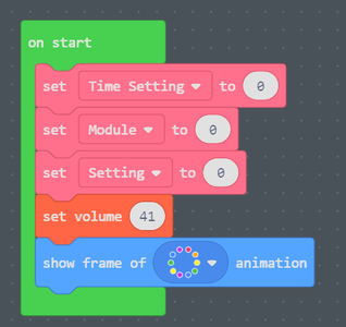

Step 1: Code Your Adafruit Playground Arduino Circuit
You will create three variables, you can name them however you want. For me I used these three terms:
  • Time Setting - Helps the Arduino know which time setting it will be running. Whether that's 30, 45, or 60 minutes
  • Setting - Helps the circuit know if the user is selecting a time setting or running the timer
  • Timer - Tracks the amount of time that is past so the RGB lights can change in accordance

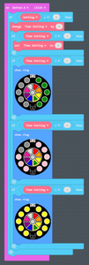

The screenshot of the timer code only shows the code for the 30 minutes setting. For the other settings you will simply just need to copy and paste the code.
After pasting the code, adjust the timer variable so that it lines up with the setting. In addition to that, make sure to change the if statement to the corresponding time setting.
Every 5 minutes is 300 seconds so just adjust the time increments by 300. You may have to double that for some because there aren't enough RGB lights to tick down every 5 minutes
Example:
For 30 minutes you would set the timer at 1,800
Then set the pixel if statement to If timer = 1,500 set pixel to "RED"
