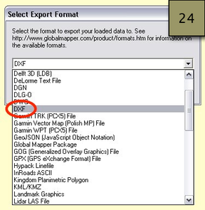

Step 5: Export and Visualize on Google Earth
Export the project in KML/KMZ format to visualize it on Google Earth, and also export the file in DXF format to later proceed to the 3D modeling on Google SketchUp.
21 - File -> Export Vector Format
22; 23 - Select KML/KMZ -> OK
24; 25 - Select DXF -> OK
