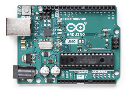

  1. Arduino

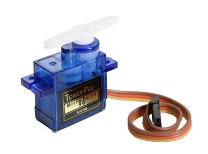

  2. Servo Motor

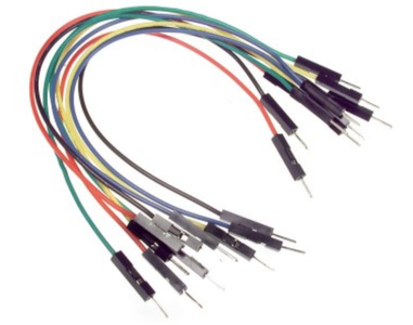

  3. Wires

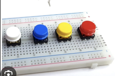

  5. Buttons
  6. Wires

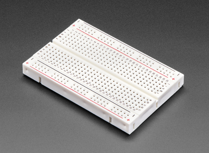

  7. Bread board

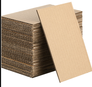

  8. Cardboard

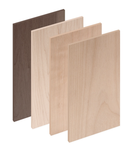

  9. Wood

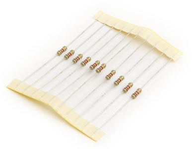

  14. Resistors

I focused more on the coding and circuitry of the device, while my partner focused more on the enclosure and soldering of the device. My next step included understanding the coding behind the motor used. I researched online projects that had already been completed using our specific motor and looked at resources that provided code for the motor used. I took coding our prototype step by step, I first got the motor to work using the code I found online, I then used my teachers lessons to understand the coding behind the lights and the buttons. Throughout each step of the process I had to look up the specific circuitry for each component to work. Getting each component to work individually was easy to do, the hard part was figuring out how to make all the components (lights, buttons, and motor) work together in harmony. I was able to figure out the majority of the coding and circuitry by myself using the resources I found, but when I ran into roadblocks I asked ChatGPT to help identify the error and offer potential solutions. I was able to figure out how to code the machine in a way where everything worked together in harmony which led to my next step of playing around with the delays to ensure that the hinge for the door opened only after a certain time and only remained opened for a certain time. I had to repeat this step two times to make all three buttons have different delays for the hinge on the door to open.

Once I finished the coding and circuitry I handed the project over to my partner where he created our enclosure using illustrator, box.com, and the CNC machine. He got the model from box.com and made edits in illustrator. The CNC machine was used to cut out the wood we needed for the enclosure. He soldered the buttons and lights with the wires that were put into the breadboard. Together we taped up the enclosure, made the hinge connected to the motor, and the front piece that would hold the snacks using scissors and tape.

The end result of our project was a fully functional prototype that held snacks, dispensed snacks after pressing one of three buttons, and waiting for a delayed period. Lessons I learned from this project included knowing how to troubleshoot problems that are faced when trying to make each component work together in harmony, both in the physical and digital realms. I also learned the importance of calm technology and how a machine can sit in a space as part of the environment rather than against the environment it sits in. I also learned the value in team projects, as we were able to divide tasks and create a solution that exceeded our expectations. For future steps on this project I would consider putting more time into the enclosure to look more polished. Our prototype is taped up, made from a mismatch of material, and while functional doesn’t look aesthetically pleasing. Another issue we would like to address in the future is the light circuitry for the yellow button. When I first made the prototype it worked, but later on the light stopped working. The code is correct and the circuitry looks to be stable so the problem may be in the light running out of power, however further investigation will have to be made in order to deduce the problem. The other two lights worked perfectly fine and I believe showcased an excellent way of emulating feedback using glowing lights without demanding attention.
