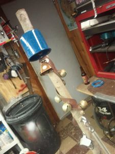

Step 1: The Build
It's a really easy build. Google Image Search Stumpf Fiddle to see how others made them. Then just slap everything on in a way that you'd like to play it. Watch the time lapse video to see how I built mine. Nothing is set in stone. I used a hose clamp to attach the cup, you may use bailing wire. I put the tomato paste can on the bottom, some people put tennis balls or dog squeaky toys. This is hillbilly harmonics at it's best.
