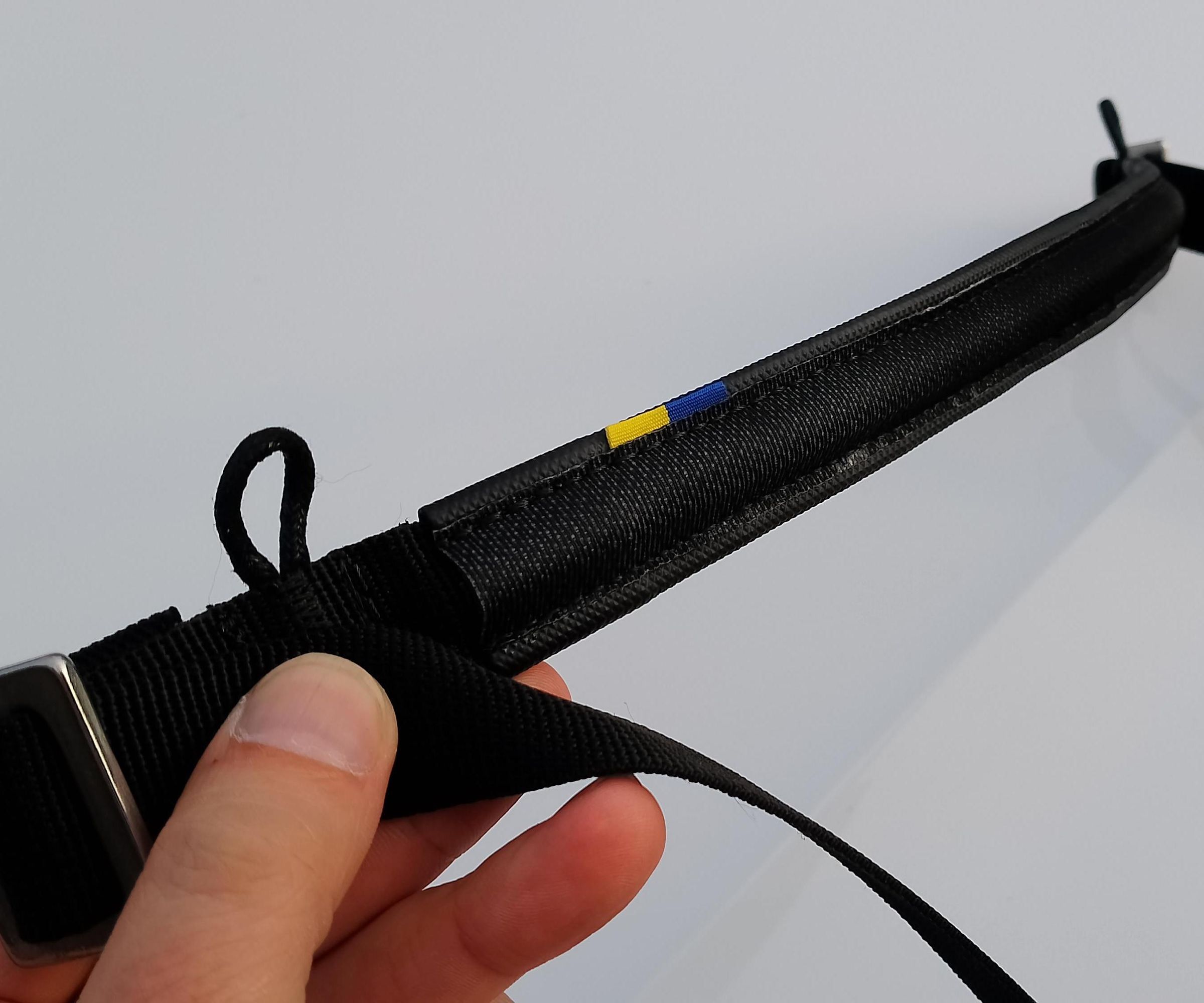

Step 17:
And here are some prototypes I made earlier. The first one shows how the sling is utilised. This one I made out of old bicycle inner tube, and althought I don't quite like it, it still shows how it works.
Also you can go all the way crazy with the protrusions and create although not very functional (arguably those can be used as containers of sorts) but very cool-looking designs.
