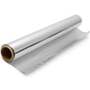

    4. Aluminium foil

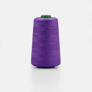

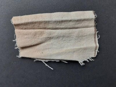

    5. Small piece of cloth (colour as you like)
    6. Thread

    Now in this step we are going to make the most important part of the stylus i.e., the tip. For this purpose we are going to need a aluminium foil.
    First of all cover the ball stucked in spring with a layer of foil
    Secondly take some foil and a ball out of it and do remember the size of ball(foil) should be smaller than the size of matellic ball.
    Third, place the foil ball on the top of matellic ball and cover both with some layers of aluminium foil.

    At this step our raw stylus is been made now some final touches are left which are necessary too because these are not only to make stylus look good but also making it good for your smartphone's screen also because aluminium is a metal and can make some scratches on screen so for this purpose we are going to need a piece of cloth and thread.
    Now cover the whole tip with the cloth and tie it with the help of thread and cut out the extra part of cloth and again tie it to make it look good.
