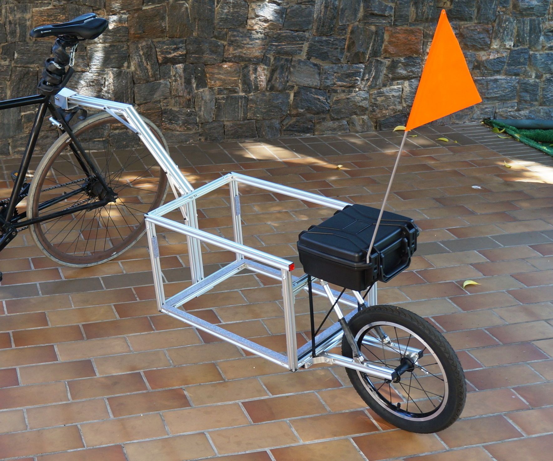

I have a bike trailer already (which I made myself too) and I took it's width as a start point, along with the minimal height necessary to fit the plastic horn, the woofer grid and the port at the bottom to dimension the front of the box. So, the free factor for calculation was the depth of the box.
