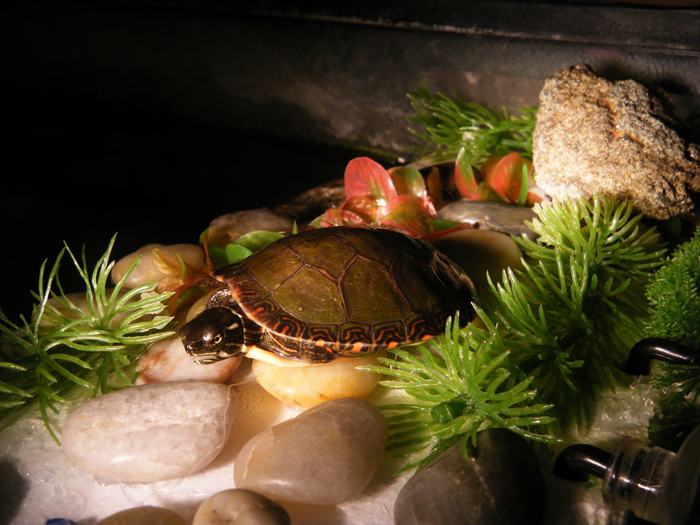

Take any remaining fake plants, or plastic, and glue it to the front of your styrofoam dock. This will even further discourage your turtles from biting the styrofoam. If you think the top is now adequately covered with decor, and you think the neighbour turtles are going to be eyeing up the crib, do this final part. Hot glue tends to leave lots of annoying little strands of glue behind. If you are concerned you can take the time to peel all of the little strands off. This is what I did.
Now is the finale you've all been waiting for! Carefully lift up your new dock, and place it in the tank where you would like it to sit snugly. YOU'RE DONE! Yay!
Don't be worried about the glue coming undone in water. As long as you let the structure dry fully before putting it in, it will hold up fine.
Enjoy the pictures belooowww, and be sure to comment. I am interested to see pics of your designs, as well.
