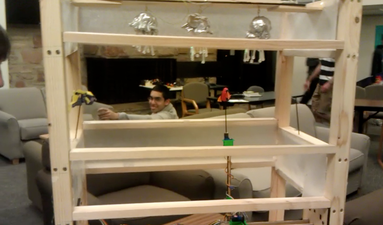

The following steps will, despite their manufacturer's best efforts, demonstrate the modification of sub-micro servos for continuous rotation with position feedback. We leveraged this process for a 4 axis positioning system, but it may be useful in your other projects as well. Anyway, our build used the Hitec HS-55 servos, but other servos of similar size should also be modifiable with similar steps. Note that if another type of servo is used for the aquarium project, the CAD models for the 3D printed parts may need to be changed as well. This was part of a project for the spring 2012 Things That Think class at CU Boulder.
