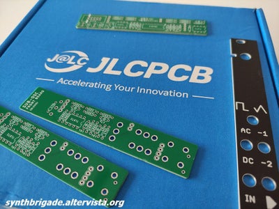

I will also share with you Gerber files to have PCBs manufactured by pros and have it ready into your case in little to no time (oh, well, this is up to your soldering skills actually!!).

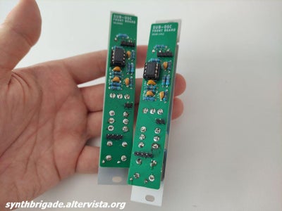

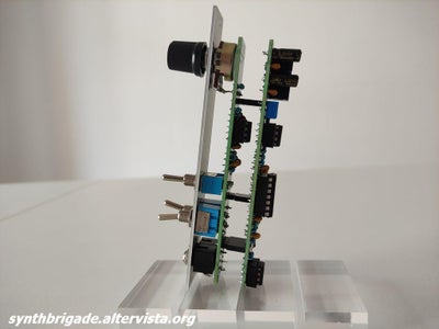

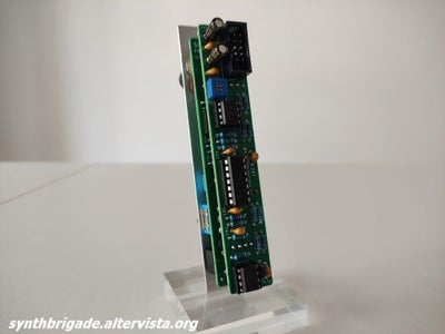

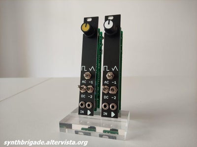

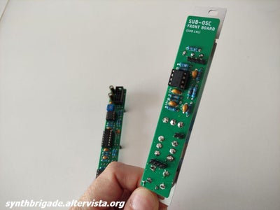

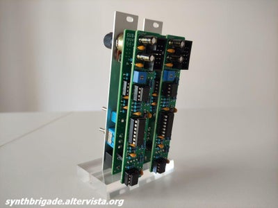

The sub oscillator module is made of three boards:
  1. main board, with most electronic components
  2. front board, with other electronics and user interface elements (potentiometers, jacks, switches)
  3. front panel, for case mounting (no components here).

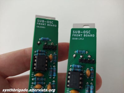

I realized two different versions of the front board, one with a direct control over sub oscillator volume, the other with a blending function between main and sub waves. The main board is compatible with both front boards, so one could swap one ore the other to test which works best for him.

Front Board (sub level)
Integrated circuits
1x TL072 dual op-amp
Resistors and potentiometers
1x 1K ohm resistor
1x 10K ohm resistor
1x 47K ohm resistor
1x 68K ohm resistor
6x 100K ohm resistor
1x 100K ohm potentiometer (WH148)
Capacitors
2x 47 pF capacitor (non polarized)
2x 100nF capacitor (non polarized)
Others
2x mono female jack connector (PJ301M)
3x SPDT ON-ON switch (MTS102)
2x 4 pin male pinheaders*
1x 2 pin male pinheaders*
Front Board (blend)
Integrated circuits
1x 1K ohm resistor
1x 10K ohm resistor
2x 47K ohm resistor
1x 68K ohm resistor
7x 100K ohm resistor
Capacitors
Others

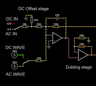

First Stage
The square wave is generated directly from the incoming main oscillator waveform. Since this is a standalone module, meant to be compatible with all sort of environments (or at least the most part of them), I had to take into consideration that the incoming wave could be AC-coupled (Eurorack systems standard), or DC-coupled.
To account for this, a DC offset circuit is placed at the very first stage of the design.
A "doubling" stage follows, where the incoming wave is (a) sent to the final mixing stage (or to the blend stage), (b) buffered and sent to the sub-oscillator generation section.

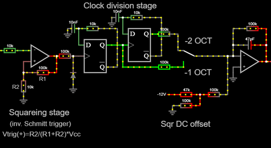

Squarewave Sub-Oscillator Generation
The sub oscillator generation section is in charge to turn a "copy" of the incoming wave into a square wave.
An opamp in Schmitt Trigger configuration comes first, "squareing" the original waveform for further processing.
The opamp in this configuration outputs a square wave with "maxed" amplitude (+/- the power supply voltage) and threshold voltage given by the values of surrounding resistors.
The trigger is dimensioned such to have threshold voltages of +/-1V circa. This makes it possible to generate the square wave even starting from low amplitude incoming waves. To have further room for "weak" signals/waves, the wave "copy" hitting the sub-osc generation circuit arrives already amplified from the "buffering" stage.
Out of the trigger circuit we then have a square wave with the same frequency as the original wave and max amplitude (+/-12V in eurorack systems).
Nex step is to half the frequency to lowen the square wave pitch of at least one octave. The frequency is divided by using the square wave as clock source for a D flip flop integrated circuit (CD4013), a well known approach (Roland adopted such in the SH101 synthesizer).
At each rising edge of the clock, the flip flop outputs a HIGH or LOW signal at the same voltage it is powered with, thus generating a square wave with half the clock frequency (one octave lower, it is).
By placing more D flip flops in series we can further divide the frequency of the clocking square wave.
Two flip-flops are housed in a single CD4013 IC, making it straightforward to design a two-stage frequency divider.
A nice thing about D flip-flops is that, even if commonly used in digital circuits, they tollerate a "high" incoming voltage with no problems, but no AC-coupled clock signals. A rectifying diode is then included to ensure proper operation.
The signal at flip-flop output has the same amplitude of the voltage juicing it, so we end with a lower frequency, DC biased, 0/+12V square wave.
Although the human ear cannot distinguish between AC or DC-coupled audio signals, offsets become significant when summing multiple signals. For this reason, an AC offset circuit completes the sub oscillator generation circuit.

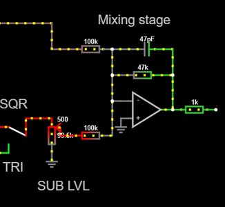

Final Stage
As a final step, we want to mix the incoming waveform and the internally generated sub-oscillator.
Before hitting the mixing stage, the sub-oscillator level can be attenuated by a potentiometer in voltage divider configuration. This is the configuration of the "sub level" front board.
I also liked the idea of a blend control over direct wave and sub osc level, instead of the control over sub level only, then designed a second PCB version.
The blend control is made through a potentiometer linking the two waves before the final mixer section. The amount of attenuation of one wave with respect to the other is determined by the fraction of signal grounded by the potentiometer.

After completing a first version, another feature made it's way in my head: having at least two sub waveforms. Square wave is "aggressive", you know, and the choice of many synth manufacturers, but I knew I could cook something to add at least a "softer" triangle wave.
An op-amp in integrator configuration is enough for the task, but I had he 4HP limit in mind and could not increase the number of ICs (the PCB was already full of components: no space left!).
I then decided to remove a first pure buffering stage for the incoming waveform and use that opamp for the square-to-triagle conversion. The waveform "copy" going to the sub generator circuit was already buffered, so it had no effect on the overall quality of the direct signal.
After that I also designed a third version, with blend control over direct wave and sub oscillator, instead of sub-oscillator level alone. This was at the cost of two more resistors only and a clean solution to give user some control over the direct wave.
Both second and third versions were interesting to me, so I decided to have them both manufactured. The circuit modifications between the two were kept limited to the front board, so I could have a single, shared main board.
I ended up with a 3U, 4HP-only eurorack module with two different flavours of waves level control, two octaves range and two sub waveforms.

Many thanks goes to the nice girls and guys at JLCPCB for sponsoring PCBs manufacturing for this module.
Without their contribution this project would have never reached the current level of development, like many others projects of mine now.
In this run they also sponsored the production of a rev.2 of the CV mixer panel board, the original having a minor offset issue in the design. This made it possible to check the new design and share a now perfectly fitting panel board.
JLCPCB is a high-tech manufacturer specialized in the production of high-reliable and cost-effective PCBs. They offer a flexible PCB assembly service with a huge library of more than 600.000 components in stock at today.
3D printing is part of their portfolio of services so one could create a full finished product, all in one place!
What about nano-coated stencils for your SMD projects? You can take advantage of a coupon and test it for free in these days.
By registering at JLCPCB site via THIS LINK (affiliated link) you will receive a series of coupons for your orders. Registering costs nothing, so it could be the right opportunity to give their service a due try ;)
