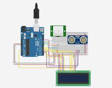

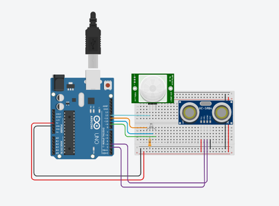

Third: We then take our motion sensor putting it on our breadboard, then connect a red power wire to the middle leg (power leg) of the motion sensor and a black ground wire to the right leg (ground wire). Now connect a wire to any pin (copy mine for now) on the Arduino then bring that wire, connecting it to the left leg of the motion sensor also known as a signal.
The power and ground wires are there to power the component and the pin being connected is so that it can input on the Arduino allowing the motion sensor to work when motion is detected.
Fourth: We should now connect the distance sensor to the breadboard, the very far left leg and far-right leg are known as a VCC (power pin) and GND (ground pin), connect a red power wire and a black ground wire to those pins (like my photo). Connect one Arduino pin to the middle left trig pin and then connect another Arduino pin to the middle right echo pin.
The power and ground wires there to power the distance sensor. The two Arduino pins that are connected to the distance sensor will allow it to work, the trig pin will send a signal and the echo will return the signal.
Fifth: For the final step of wiring the components we can take the LCD and just keep it beside the breadboard because it does not fit on the breadboard. Connect it exactly as I have connected the LCD display especially with the wires. Connect a red power and black ground wire to VCC and GND, you will also need to have these wires connected to LED anode and LED cathode. When connecting to the LED anode make sure you connect our 2nd 330-ohm resistor so that the LCD does not explode. Also, make sure to connect VD/contrast and RW (read/write) to GND, this will ensure that words or numbers will actually be displayed on the LCD. Then connect Arduino pins to register select, enable, and then the pins DB4-DB7.
This will ensure that the LCD will actually work, once it has been coded.
