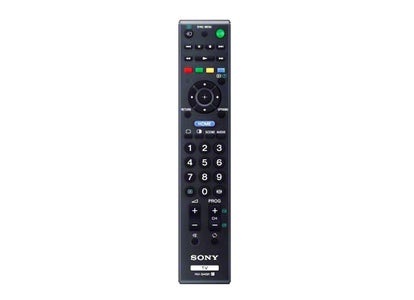

  4. down the blue button i found the info button (+i)
  5. while the movie plays press the button to enable reading the attached subtitle

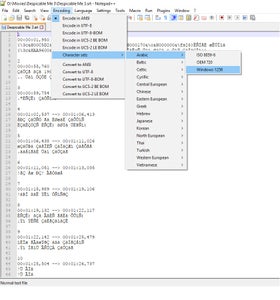

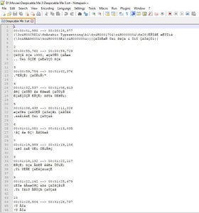

  7. if not and the language is squares or strange figures .. remove the USB flash memory and attached to your pc
  8. download notpad++ program
  9. open the subtitle file
  10. from the tabs above choose encoding
  11. choose you language and coding (for me: encoding > charachter sets > arabic > windows-1256) ... you should now see your language
  12. from encoding choose convert to UTF-8 and save
  13. repeat point 3 to 6
  14. if not and the language is still squares or strange figures .. repeat 9 to 11
  15. from encoding choose convert to UTF-8-BOM and save
