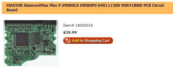

Step 2: Find the Serial / Part Numbers on the Drive
For my model of Maxtor hard drive there were three different numbers I needed to identify a replacement controller board:
Drive Code Number: YAR41BW0
First 7-digits of the drive Model Number: 6Y080L0
9-Digit Code number on the largest IC on the controller: 040111500
Edit: Also I found that not all models of Maxtor hard drives have bios chips (refer to picture). If your old controller has one then make sure your new controller does as well. If your old controller does not have a bios chip then I assume you will want to find one that also does not have a bios chip.
Step 3: Procure a New Controller
Now that you have all the numbers you need there are two different routes you can go.
1. Go to ebay and find a working drive for sale that matches all of your numbers, buy it and cannibalize the controller. I investigated this option first but was unable to find a match for my drive, you may have better luck.
2. Find a supplier that sells new replacement controller, they will be more expensive than option number one, but you will be paying for a new part and will morel likely find the exact controller you are looking for. This is the option that I went with.
This is the vendor I used:
Hard Drive Parts.com

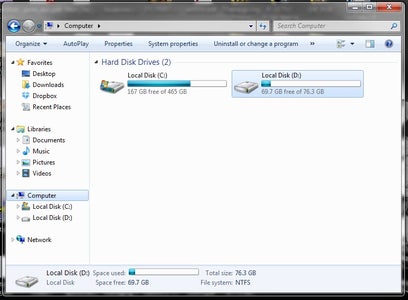

Step 6: Download Your Data
After you have replaced the controller you will need to power up the hard drive and connect it to your computer.
I am not sure if the order matters, but I first connected the USB to IDE adapter between my Laptop and hard drive, then I powered up the hard drive.
I used a PC power supply to run power the drive while I backed up the data. If you use this method you will need to take a paper clip and short the green wire to the black wire in the 24 pin connector to get the power supply to turn on.
If you are fortunate enough to get your hard drive to come back to life, don't dilly dally, back up all your data ASAP, just in case something else decides to fail.
