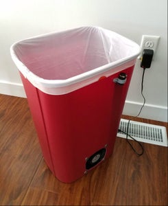

This is a little project I came up with to solve the issue of trapped air under the bag. A simpler solution would be to drill a few holes in the bottom, but where's the fun in that?? Now my kid LOVES to take out the trash for me!
When the button is pressed, the fan sucks all the air out and creates a nice fit for the bag inside the can.
My initial prototype was built with spare parts I had laying around and cost $0 to make, but I wanted to get a little "fancy" and added a switch.

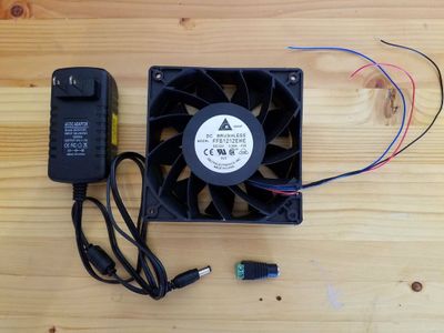

Step 1: Parts
The only real important thing to note with these parts is the AC/DC adapter should have the same voltage as the fan and approximately the same current.
Here I use a 12 volt / 3 amp fan and adapter so there should be no issues.
The hardware and wire I already had laying around but I recommend using a wire gauge (thickness) that is slightly larger than that on the fan. Smaller wires may not be able to support the load current and could potentially get hot. Bigger is the cooler (temp) and safer option.

Step 11: Plug It In, Plug It In!
Last thing is to plug it in and try it out!!
If you followed all these steps correctly you should have no troubles.
If you don't have a good enough seal around your fan you can use a silicon caulking to close up any gaps and improve the performance.
Overall this was a fun, simple project that has impressed all my family and friends. My daughter won't even let me replace the trash bag without letting her push the button. And though my wife objects to all of my projects, I've noticed she doesn't ask me to take out the trash nearly as much as she used to!!
