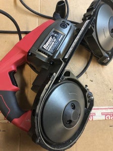

My Bauer portable power metal saw from Harbor Freight worked well for many months. Then I installed GFCI outlet protection in my workshop. Suddenly my saw tripped GFCI outlets. It is no longer under warranty. I have received no electrical shocks from the ground fault. An Ohmmeter shows no continuity to ground. This Instructable shows the problem and how I corrected it. Hopefully, it will save someone from condemning a good tool, even if it is not a metal saw from Harbor Freight.

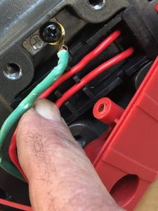

This is a spoiler alert. The problem was in the area of the air vent to which my finger is pointing and forward of it. That means you do not need to dismantle more than the plastic castings for the handle and its mounts. Nor should you panic as if the motor or variable speed control failed.

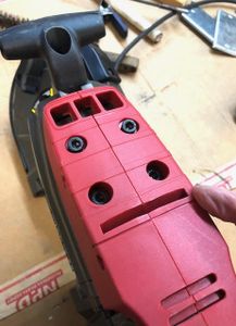

Step 2: Opening the Handle and Its Mounts

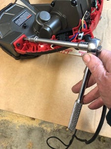

Use a medium Phillips screwdriver to remove six screws. (first photo) Use a hex wrench to remove four large screws. (second photo) Remove two large screws that anchor the lower end of the handle. (third photo) A socket drive for these two screws is really helpful and saves a lot of time.

Tap on the photo and read the text notes. When I opened the handle section, red power wires to the motor crossed over one another. They did not appear to be in channels designed to keep them from being compressed together. One of the challenges for reassembly is to keep wires in their desired places. But, I also strongly suspect the person who assembled this tool just put the wires into the tool without much concern that they would not be compressed against one another.
I have had a couple of previous experiences with ground faults, etc. Everything works fine and appears good initially. But, there is compressive force on wires from other wires or from something metal that is not to be part of the circuit. In time the compressive forces push insulation material to the side and the thickness of the insulation diminishes until there is enough electrical leakage to trip a GFCI or even cause a shower of sparks. Yet, if you look at the wires you may not see any burn marks and the insulation appears intact. But, it is not.

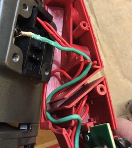

Step 4: A Place for Each Wire
Look for formed channels where wires are supposed to rest and place them in those channels. The insulation on the red lines to power the motor is relatively thin. The pre-formed channels for them keep them separated. (Notice there is a recess for the terminal fitting on the green ground wire, but it is not in place in the photo. Move it into place, too.) Some adhesive, like auto body adhesive, could be put into the wire channels to hold the wires in place, but would require time to dry before it would be effective.
If insulation appears to be compromised and available space inside the tool allows, use electrical tape or shrink wrap tubing to restore the insulation.
