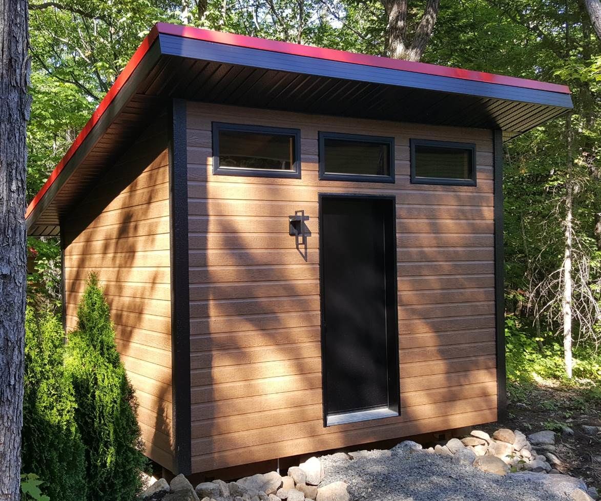

Building my own sugar shack has always been a childhood dream!
Being a father who works full time, 3 seasons have passed between the design and the final construction ... A major work yes, but I am very proud of the result ! I have attached all the necessary documents (3D model, 2D drawings, photos) and I encourage you all to embark on the adventure of making your own maple syrup. Of course, if you have maple trees in your surroundings ;-p

Step 10: Siding, Door, Soffit
Last big step before having a shack sheltered from bad weather ... the siding !
One board at a time, nail by nail ... It took me around 12 hours to complete the job ... the most beautiful thing ... it cost me 0$ for all that wood ... (Only my time to remove all staples from the crate) ... but still, a nice way to recycle things !
I bought a really nice and neat door from kijiji (online classified advertising service) ... full metal ... and the color match perfectly with the roof ... almost Magic !
