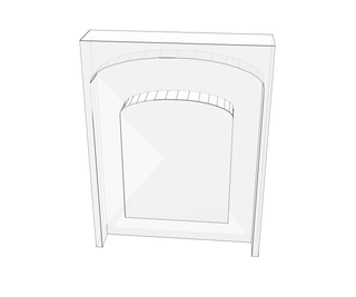

First we, need to design the loop. To do this, decide on a shape and form it by hand, or use a mold. I chose to make a mold, to try and get a more professional looking result. Once I sketched out the basic shape, since we have access to a 3D printer, I used Tinkercad to make the shape all precise and fancy.
If you design your own, design the actual shape of the loop first, then set that shape to a "hole" in Tinkercad and combine it with a block, making sure it comes above the top face of the block. When you group them, you'll get the negative of the object, which can be printed to make the mold. If you want to see what I'm talking about, or if you just want to use my design, I've included the STL file from Tinkercad for reference, or printing.
If you don't have a 3D printer, you can form the loop by hand, or make a mold in a different way. I've previously had success with making a negative out of stacks of plastic sheet glued together.
