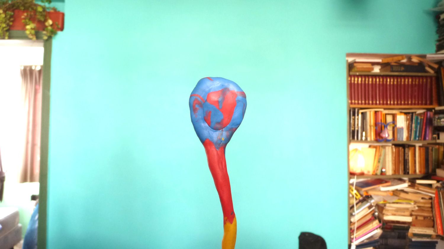

Altought the simplicity of the project, some things can go wrong, like in my case. Once finished the sugru part, using 3 packs, i remember that i have to check the mic again, just to find that it doesnt work anymore! The manipulation of the mic when covering with sugru make the solder of the piezo to tear off, and i didnt note this until i plug it. So, with the clock ticking -you have 30 minutes to manipulate the sugru- i remove all the sugru, find that the wires of the audio cable were really thin and in a hurry have to find another cable and solder another piezo to start all over. The cover again with the sugru, now mixed in blue and red.
A pesar de que parece tan fácil, alguna cosa puede fallar. Cuando terminamos de poner el sugru -3 paquetes- y volvimos a probar el mic, no andaba!! Al manipularlo, sobretodo porque el sugru se adhiere bastante adonde lo apoyes, se desoldó el cable. Así que tuvimos que sacar todo el sugru, mezclarlo y volver a armar. el problema resultó ser que el cable usado era muy finito y se quebraba fácil, así que en la media hora que da el sugru para manipularlo hubo que apurarse y armar otro mic de contacto y volver a sellar, esta vez en una marmolado de rojo y azul.
Step 5:
Once we left the problems behind, and double tested that the mic is still working, its time to use the remaining sugru to cover the cable for waterproofing. Ours ended up looking like something done by a very special infant, but yours could look better. The sugru needs 24 hs to cure, so we hang the mic on a window to avoid sticking, and wait.
