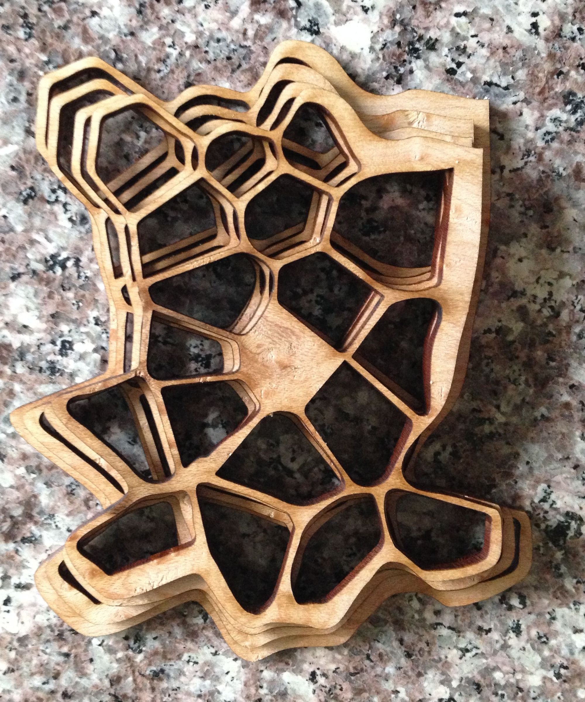

Another chrissy pressy I made for good ol' mumsie was a set of wooden coasters. Originally I wanted to make some kinda cheesy smiley face by cutting holes, but after seeing Wallace and Gromit's A Grand Day Out, I got a little more creative...
I used a 1/4 inch thick wood with a width of 5 inches for this project. I made two different sizes, in sets of four and eight. And the file was produced in Illustrator CC (though I saved it out as a SC6 file). This is important, because Techshop has CS6 installed, and if you try and open a CC file in a pervious version bizarre things occur to vectors.....
made at Techshop!
made at Techshop!
