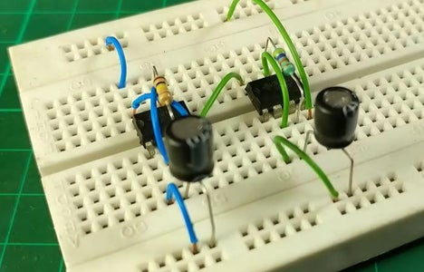

Step 1: Starting to Build the Circuit
Place 555 Timer IC On Breadboard
Step 2: Adding to 555 Timer
Place wire from Pin 1 of the 555 Timer to negative rail.
Then, place wire from Pin 8 to positive rail.
After, place wire from Pin 4 to Pin 8.
Then, place wire from Pin 2 to Pin 6.
After, place 100k ohms resistor from Pin 3 to Pin 6.
Finally, place a capacitor from Pin 2 to the negative rail.

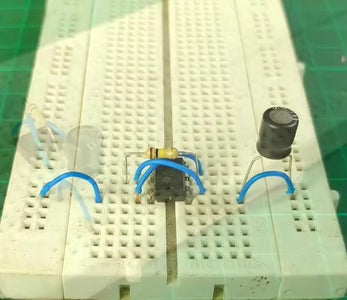

Step 3: Second 555 Timer
Place another 555 Timer IC
Connect Pin 3 from the first timer to Pin 8 of the second timer.
Pin 1 of second 555 timer goes to negative rail via the wire.
Pin 2 to Pin 6
Place 47k ohms resistor from Pin 3 to Pin 6.
Pin 4 to positive rail via wire.
Finally, place the second capacitor to negative rail via the Pin 2 of the 555 timer.

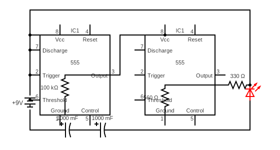

Step 4: LED & Resistor Placing
Place the LED
Connect the wire from the anode of the LED to the positive rail.
Pin 3 of first timer to the 560 ohms resistor.
Place the resistor to the c41 hole.
Step 5: Attaching Battery to Power Circuit
Attach Battery cap to Battery, then put the positive wire from the battery cap to the positive rail, and the negative wire to the negative rail. Now, the LED should be blinking on and off every 5-7 seconds.
