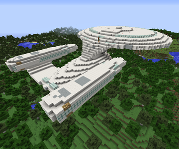

- /py render 1701d : draws a Star Trek Enterprise

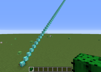

from mc import * mc = Minecraft() for i in range(100): mc.setBlock(i,i,0,DIAMOND_BLOCK)
Make sure the kids all understand what's going on, or they will be stuck for the rest of the course.
