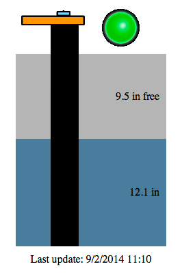

Step 9: Final Result
Voila! All you have to do now is to fixed the sensor in your pit.
Step 10: Next Tutorial
In the next week, I will show you how to present the result of the sensor on a web page.
