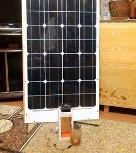

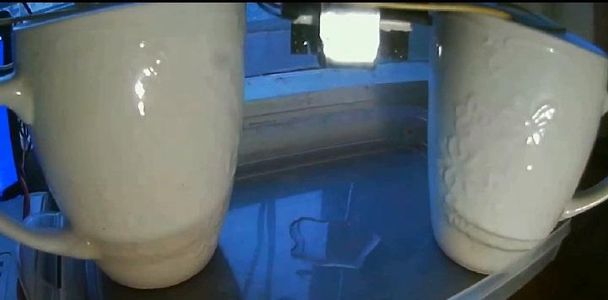

to combine several elements at once: air, water, and fire, if the sun can be called that. That's just the date and time did not put on video, in December we have snowdrifts, well, you will have a belt, but after looking, I did not repeat. So do not pay attention to the little things, but delve into the essence.

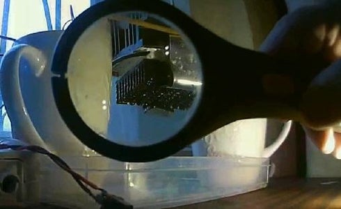

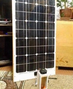

And the essence is, with the Peltier element, when I connected electricity, I got water. Think, surprised, tell you, everyone knows. But I did not use a battery that discharges and it must be charged so that the process continues. And the solar panel is 18 volt, 5 amp. Even when there are no direct sunlight, the panel under load is able to produce 4.5 volts and about 2 amperes. This is sufficient for the element to condense water and the fan to blow the hot side. In sunny weather, everything works much faster.
Peltier

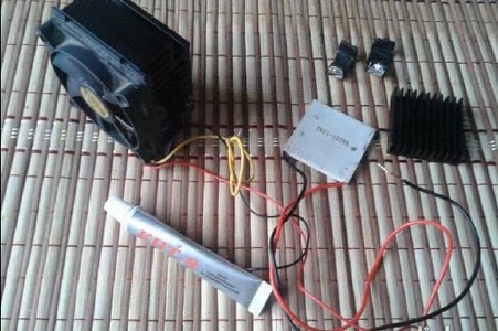

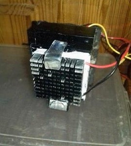

element, two radiators, fan, solar panel, plastic tape, glue and patience.
Step 1:

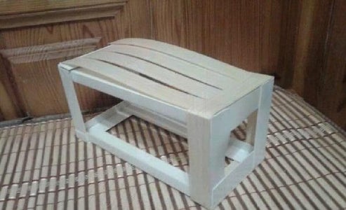

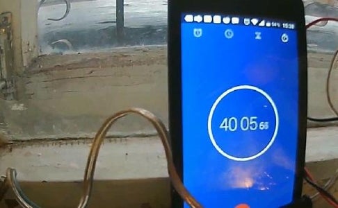

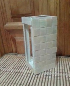

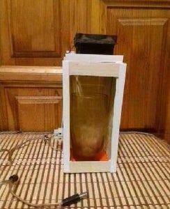

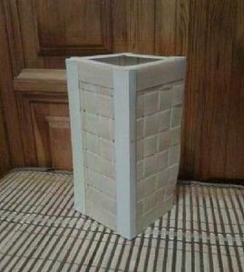

First, I checked the assembled structure of a Peltier element, a fan and two radiators. I fed 0.8 amp, 9 volt. The result pleased. The water came out after 8 minutes and literally before my eyes turned into snow. Then i conducted a test with a solar panel, cloudy weather, but after 40 minutes, a spoon of water formed. Behind the scenes, in sunny weather, the same thing happened in 10 minutes. Making sure that everything works, i made a case from improvised materials and put a glass.
I did not try to give water, who has little water, I just made an assembly to get water.
