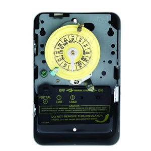

For my clock motor I used one of these heavy duty Intermatic 24 hour timers. There are small battery powered 24 hour clock motors available, but if you're making a large clock you just need to be aware that a large clock hand requires a little more torque. In theory, if you keep the hand lightweight and/or balance the clock hand it shouldn't be a problem. But I knew this kind of AC powered timer has enough torque to switch a pretty strong spring mechanism.
There's just a spring clip holding this timer in the metal box. You can also buy just the replacement clock mechanism.
There's a manual switch lever which sticks out above the yellow clock face and I used my Dremel tool to cut that off so the hand I added on wouldn't hit it.
I didn't worry about the orientation of the clock motor (which way was up) but instead just found the best existing holes in the metal that I could put a couple of screws through into my wood support.
