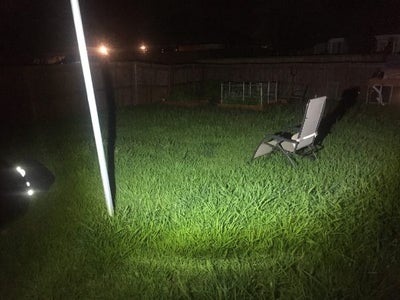

I’ve been wanting a slightly more powerful flashlight for a while now. I’ve got some brothers-in-law that have built their own flashlights and they are crazy bright and crazy small. I also wanted it to be inexpensive, so mine definitely didn’t end up being small. Its 18″ long and weighs about 2lbs. But it is CRAZY bright. Like it puts my car headlights to shame.
Also, if you're interested in seeing my other projects, come check out my site at www.sampaulling.com
The light output on this thing is insane. You can barely stand to look at it. And it generates a lot of heat so you need a strong fan and a CPU heatsink.

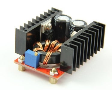

150 W Boost Converter DC-DC
This boost converter will take a 12v battery and ramp it up to 32V, which is what you need for the 100W LED chip.

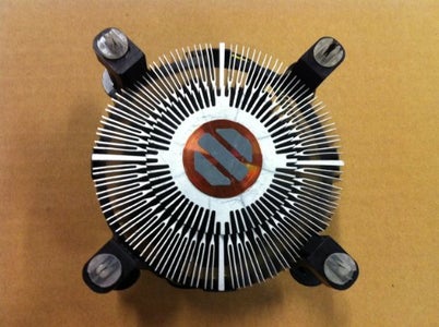

Heatsink
The LED chip gets REALLY hot after running for a few minutes. Running it by itself with no heatsink will fry the chip in about 2 minutes. You need a heatsink of some kind. I had a spare CPU heatsink laying around that also had a 12V fan attached, so I made that work, but you don’t need one quite this big.

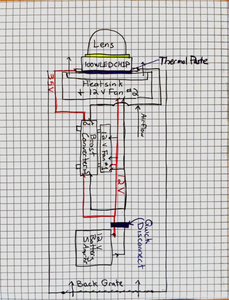

The pieces all fit in an 18″ length of PVC pipe (Mine is 4″ diameter pipe because I have such a huge heatsink, but if yours is smaller you dont need this big of a pipe.
From front to back, the components are as follows:
Lens (not shown)–>LED chip–>Heatsink/Fan–>DC-DC power board–>Switch–>Power connector–>Battery
I also have a secondary, tiny 12v fan that I had left over from another project mounted to the top of the DC-DC power board for additional cooling. Its probably not necessary but I just had it so I used it.
The way my CPU fan is situated, it actually pulls air from the back, over the battery, and out the front over the LED chip. This is probably the opposite of how most CPU fans will work. I could probably try reversing the polarity for the fan and make it run the other way, but I kind of like it.
The DC-DC Power Step up transformer connects directly to the battery at its “in” ports and the + line going from the battery to the DC-DC power converter has the switch inline. That way, no power is used when the switch is off. Once the switch is flipped on, power is sent to both the fans (at 12V) and to the DC-DC power transformer.
From the other side of the DC-DC power transformer, the wire connects directly to the LED chip. Its kind of hard to tell which side of the chip is positive and which is negative, but make sure you get it right or you can fry your chip quickly. Power is only meant to flow one way through this thing.
When you get it all wired together, try it out for a few minutes at a time to see how hot everything gets. And definitely don’t look into it. It is literally blinding. I was, and still am, shocked at how bright this thing is, being that small of a light emitter, but its crazy.
