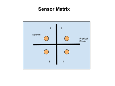

The four sensors are arranged in 2x2 matrix, with a barrier separating them. The four quadrants allow us to know how to better position the sun-tracking arm. For left/right decision, we sum up light values from sensors 1 and 3 and compare the result with the sum of 2 and 4. For up/down decision, we sum up values from sensors 1 and 2 and compare result with 3 and 4. If the percentage difference is greater than the threshold value (5%), we send a move command.
The sensors supply microcontroller with information. Microcontroller decides if the arm needs to be re-positioned. Motion is performed using a security camera pan/tilt base. This particular base uses high voltage inputs, so we need to control AC current using relays. This part of the implementation is specific to the base you are using. In our case, we needed two relays per dimension. For each dimension, first relay controls power, second relay controls direction.
