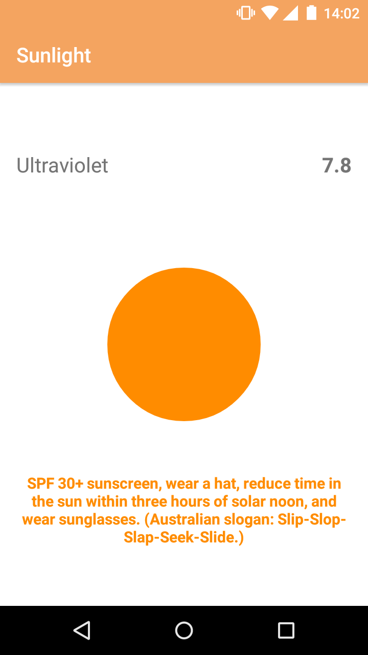

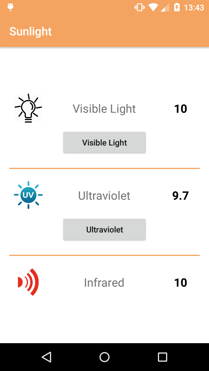

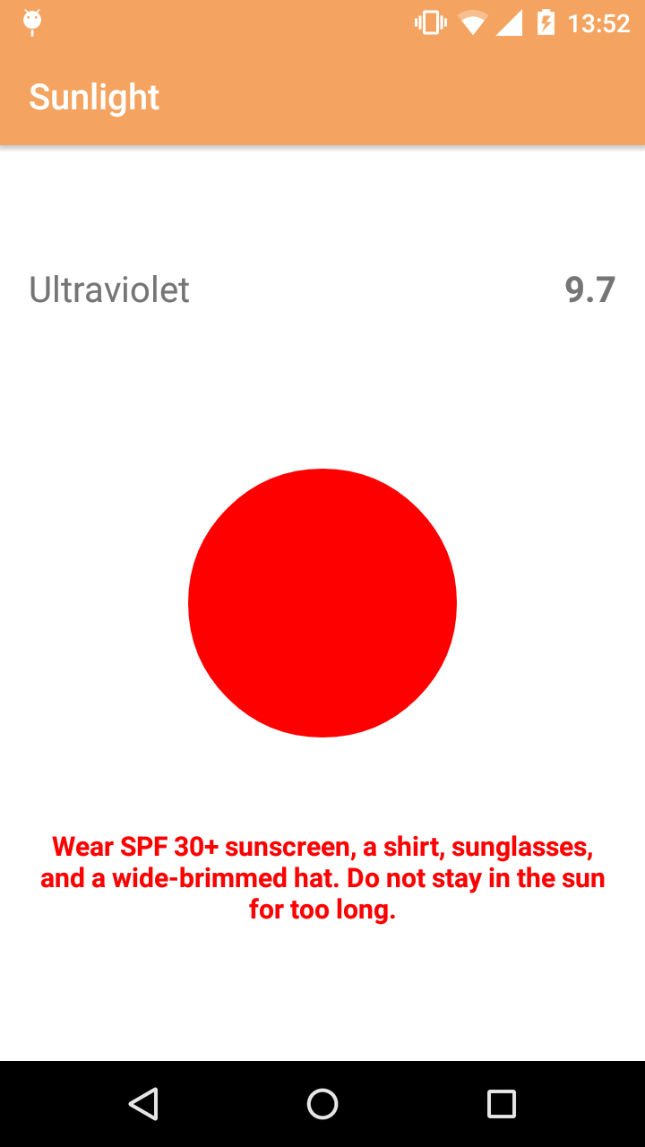

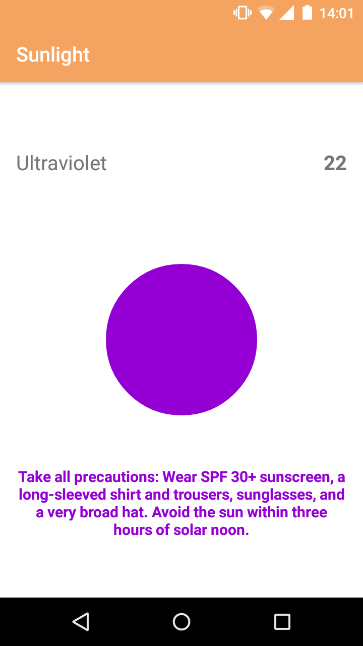

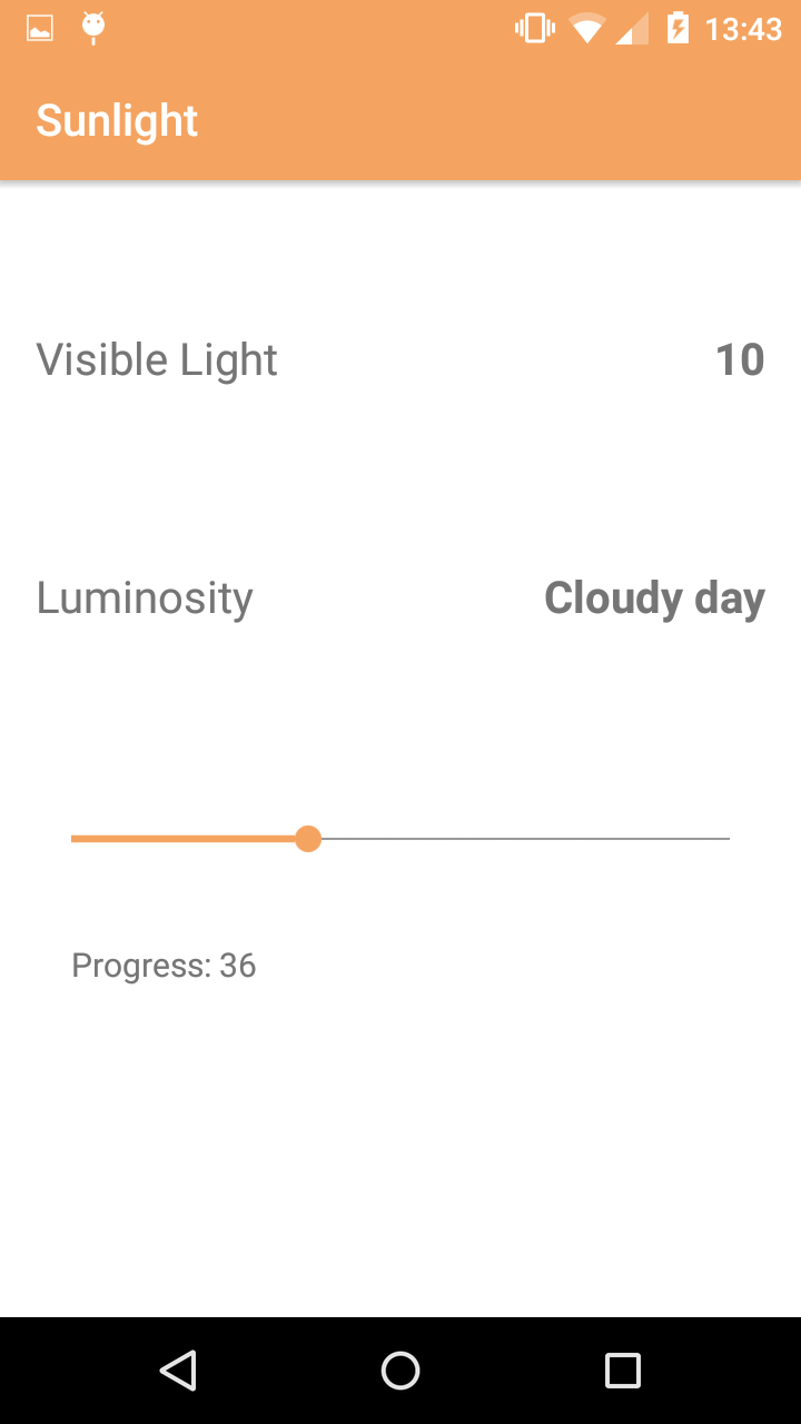

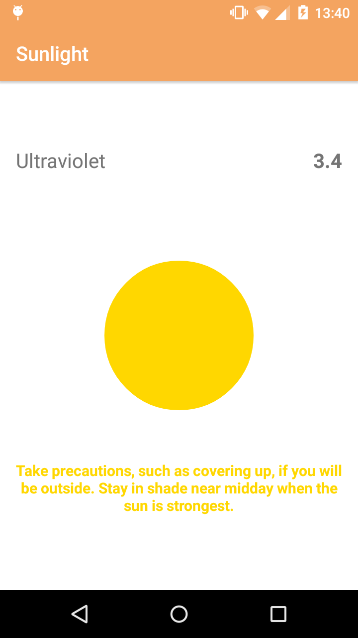

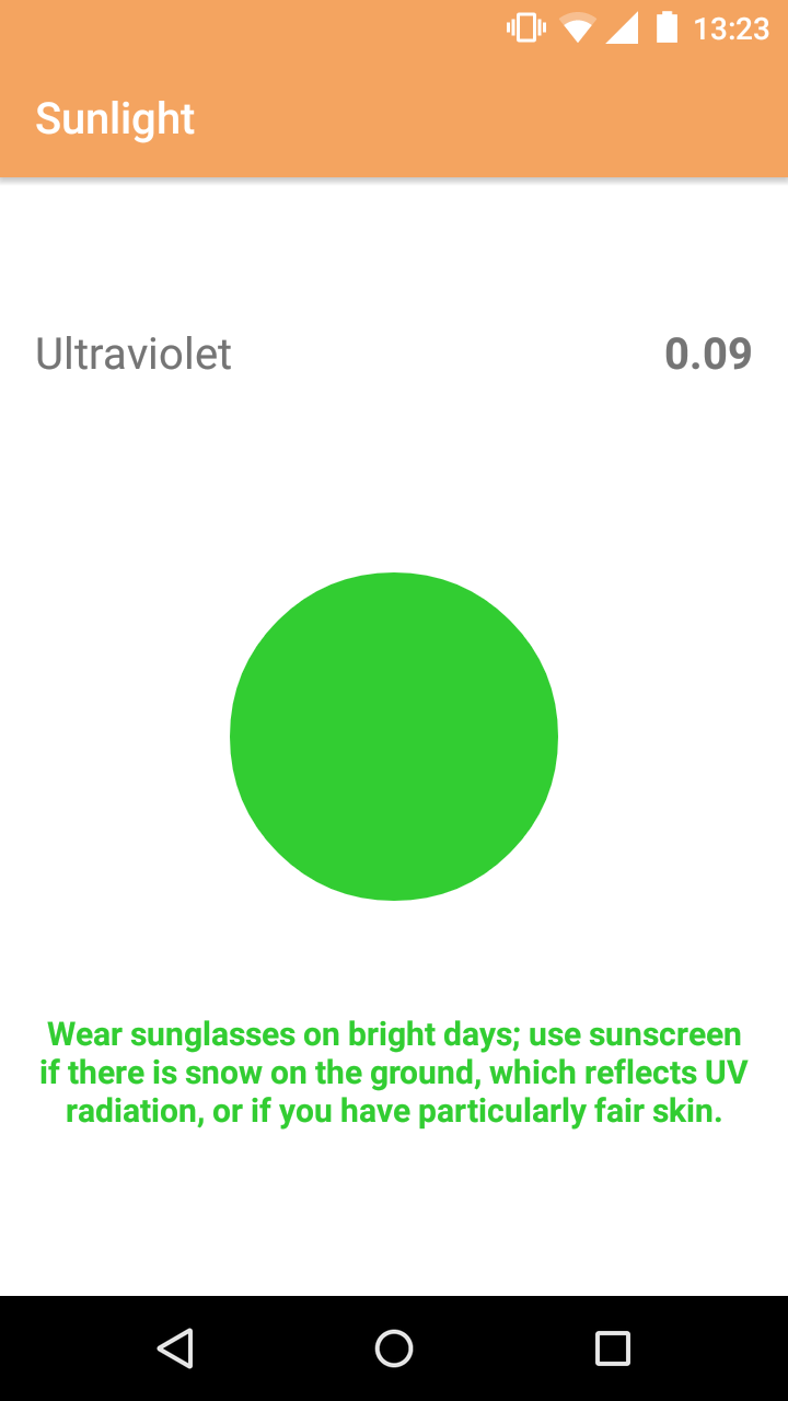

Step 3: App Screens
Screens of App that contains the information oh the sensor measures and tips with the levels for each measurements for the end user.
