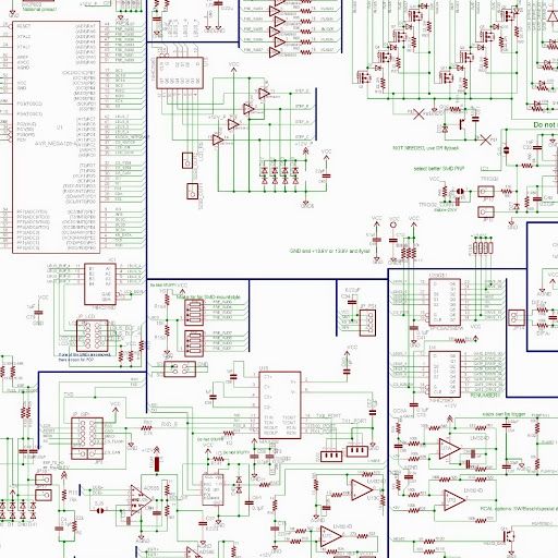

Step 10: Wire the Circuit
To view the schematic, either use the attached PDF file, the attached image, or click here.
Because going over how to build a circuit on a PCB could require an entire tutorial in and of itself, I will leave the exact details up to you. The basic theory of this process, however, is to use the schematic to lay out all of the components in a logical fashion on your PCB (in this case I had to use two due to space restraints) and then use old lead clippings and short lengths of wires to make all of the necessary connections. I recommend making all the component connections first, and then cutting lengths of wires to make any external connections (buttons, Arduino pins, etc.). Doing this may require some partial assembly of the frame, so that you can more accurately measure out the necessary lengths. I would also strongly advise you to avoid the fatal mistake I made, in which I used 14-pin sockets rather than 16-pin sockets, an error that greatly threw off my layout and required me to ghetto-mod the chips into the proper place.
**Breadboard the circuit first, to make sure that all your components work properly and to allow you to make any modifications in a non-permanent fashion!
Explanation of Circuit:
As you can see from the schematic, the circuit is fairly simple, and mainly consists of a simple module repeated many times. There is one transistor per row/column, with PNP transistors used to source the row LEDs to V+ and NPN transistors used to sink the column LEDs to GND. You'll notice a 1K resistor in between each transistor base and its corresponding shift register pin; this is simply to prevent over loading the base; omit them and you may fry your transistors! There is an additional set of 56R resistors between each column and its NPN transistor, these are current limiting resistors to prevent the LEDs from burning out. Moving on to the shift registers themselves, their connections are fairly straightforward, consisting of directly connecting the clock, latch, and data pins of two of them to the Arduino pins. The third one is daisy-chained to another one of the others. This was done to leave more Arduino pins open for the rest of the circuitry, and the two work in tandem to sink each LED column to ground. The remaining connections are for things such as the output enable and clear functions of each shift register, and these were just pulled high or low depending on how they affected the output pins of the shift registers (on or off).
The next part of the circuitry is the sunrise alarm part, and as explained earlier this is mainly a simple RC circuit that begins when the NPN transistor across both leads of the capacitor is turned off, allowing it to charge. Moving on from that you'll notice the voltage regulator that is simply taking power from the barrel jack of the Arduino (via the Vin pin) and stepping it down to a usable 5 volts. Normally I would have simply used the 5v pin, however I knew the LEDs would be drawing a lot of power and did not want to risk damaging the Arduino by drawing too much power from that unregulated source. Everything is powered from this regulator, and it provides a reliable ~2A output for the entirety of the circuitry.
The button/switch circuitry is quite simple, and is essentially a series of 10K pull down resistors attached to each input pin. Pushing each switch will cause the input pins to be connected to 5 volts, which the Arduino registers as a high input. The display-dimming circuitry is simply a 100R potentiometer connected between the emitters of all the column NPN transistors and ground. Varying the amount of resistance on this part will adjust the amount of current flowing through the display LED, making them brighter or dimmer. I understand that this is a very improper way of doing this, and that I should have used a PWM circuit along with a MOSFET, however time was running low and I did not want to fuss with such things.
