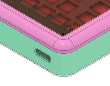

Step 2: The Case Design
- I created the case in Fusion 360
- pink- top case
- green- bottom case
- red- PCB
- translucent dark- acrylic plates
- [pic 1] overall view
- [pic 2] bottom view of the top case
- [pic 3] top view of the bottom case
- [pic 4] bottom view of the bottom case
- I put the source information of the layout from KLE into a plate generator to create SVG files to create a compatible plate for the layout I chose
- (don't forget to overlap the optional layouts over the main part off the layout before you put it into the plate generator)
- I imported this SVG into Fusion and created a 1.5mm thick plate.
- I edited the plate to include tabs, that will eventually serve as gaskets for a softer typing feel as well as to suspend the plate and PCB between the top and bottom case
- [pic 5] (from keyboard university)
- Receiving/Female tabs were designed as a part of the case that has spacing to accommodate the thickness of the plate due to both the top and bottom gaskets made from the silicone rubber sheets
- [pic 2 and 6]
- I used the dimensions from the finished PCB to size the case to my liking
- I made sure the holes for the knob, USB port, badge slot, navigation cluster, arrow keys, alphas/modifiers, and keycaps were given attention.
- [pic 7 and 8]
- A chamfer was added under the nav cluster due to the lack of clearance from the case being too close to the keycaps
- This is also where I created a slot similar to the one from the "Sunsetter" to accept the badges from my other board.
- The case was also split, with male and female tabs to connect the two halves
- [pic 9]
- Due to the size of the keyboard, I was unable to fit the entire case on the build plate of a Prusa Mk3+
- I also designed access to the bottom of the board with an acrylic plate. It is meant to a be pleasant and aesthetic window to be able to view the solder job, components, and PCB silkscreen from underneath
- [pic 4]
- I also designed an accent plate, where I would be able to offset a thin acrylic plate over the diodes that I'd be able to engrave with my designs!

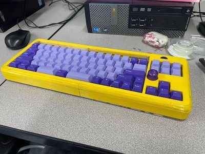

- Final Prints!!
- [pic 6]

- Done :)
