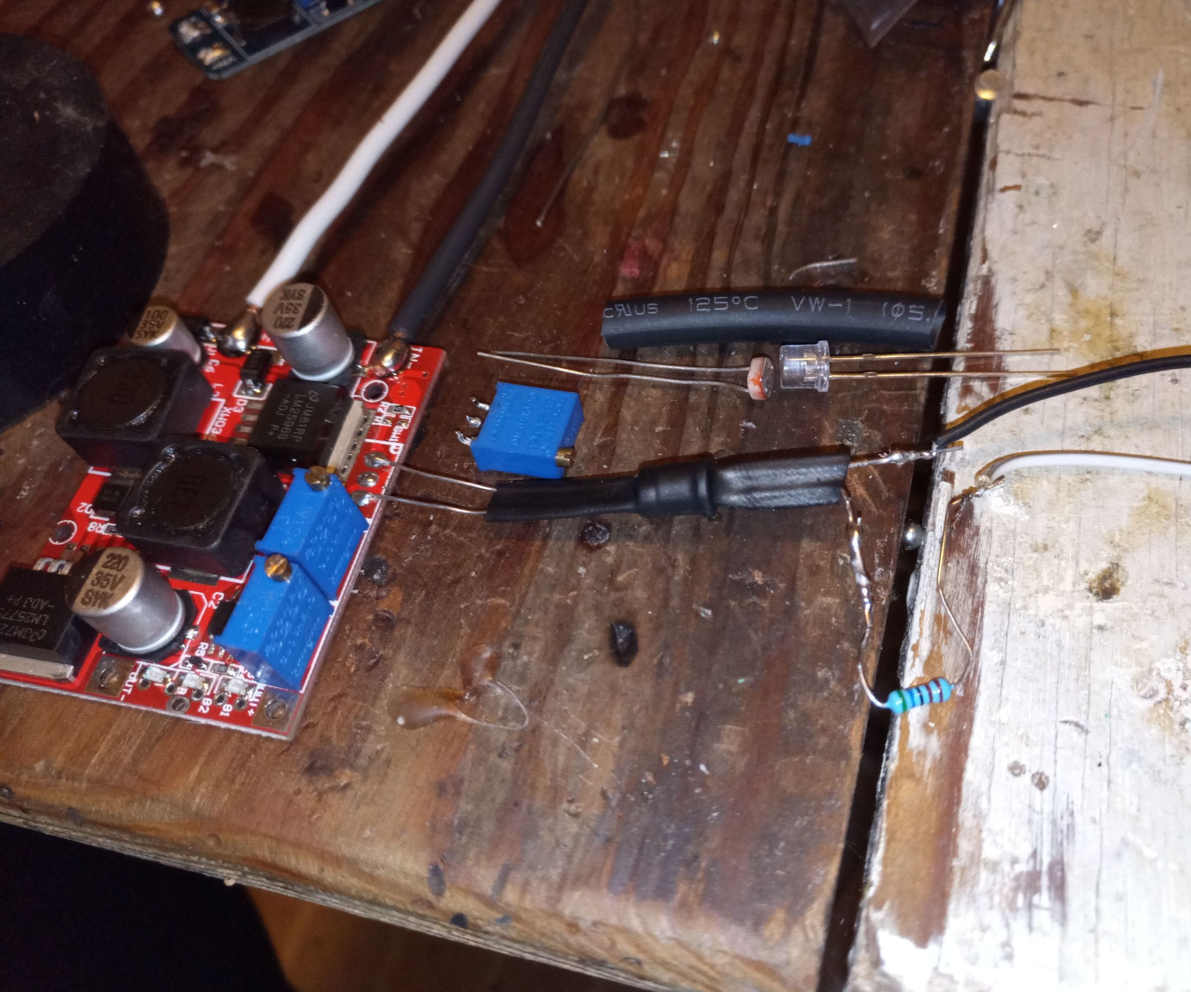

Step 2: Pi Power Controller
In order to turn the Pi on and off I had to implement a power controller with 4 DC-DC converters and a mosfet.
Sadly the Pi draws about 100mA even when off, so I had to add the mosfet to completely cut power to it. With the power controller in play, only ~2mA are wasted at full charge(~0.5mA at low charge).
Essentially the controller does the following:
- Regulates the voltage level below 2.5V in the capacitors to avoid overvolting while charging.
- Four DC-DC (1A max each, 4A total) pulls directly from the capacitors from 4.5V to 1.9V for a constant 5.1V.
- At the press of a button, the mosfet allows power to flow to the Pi. Another press cuts power.
- The ATTiny watches the voltage level of the capacitor bank. If too low, the mosfet cannot be turned on.
The silver button, when depressed indicates the power remaining in the capacitor bank. 10 blinks at 4.5V and 1 at 2.2V. The solar panel can charge to the full 5V and blinks 12 times at that level.
The capacitor voltage is regulated with the green disc 2.5V regulators that bleed off any excess power. This is important because the solar panel passively charges the capacitors through a 10A diode directly up to 5.2V which would over-charge them.
The DC-DC converters are capable of providing up to 1A each and are variable constant voltage output. Using the blue potentiometer on the top, the voltage can be set to any level you require. I set them to 5.2V each which drops about 0.1V across the mosfet. One will be the tiniest bit higher voltage output than the others and will get moderately hot, but the others will handle power spikes from the Pi. All 4 converters can handle power spikes up to 4A at full capacitor charge, or 2A at low charge.
The converters draw ~2mA quiescent current at full charge.
Attached is the Arduino sketch I am using to get this done with the ATTiny (Plenty of notes added). The button is attached to an interrupt to pull the ATTiny out of sleep and power the Pi. If the power is too low, the power LED is blinked 3 times and the ATTiny is put back in sleep.
If the button is pressed a second time, the Pi power is shut off and the ATTiny put back to sleep until next button press. This uses a few hundred nano amps in sleep mode. The ATTiny is running off of a 500mA DC DC converter that can provide a constant 5V from a voltage swing of 5V-0.7V.
The power housing was designed on TinkerCAD (as are all the other 3D prints) and printed.
For the circuit, see the crudely drawn schematic.
