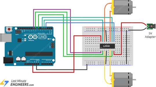

Step 1: Setting Up the Components
There are a lot of different sensors on this car so before you start you want to make sure that everything works. You want to code all of the components and test them, tweak them, and fit them to your vision before you put it all on the car. First I would make code for the motors. To do this. you want to attach a breadboard to your car chasey. You then want to set the h bridge up on the breadboard and make sure that there is room for your other components. With the given link you can learn how to code and wire the motors. (https://dronebotworkshop.com/dc-motors-l298n-h-bridge/). Next, I set up the IR receiver. For this, all you need is the IR receiver, some wires, and your IR remote. Using this link you can learn how to set up the IR receiver (https://www.circuitbasics.com/arduino-ir-remote-receiver-tutorial/). Next set up your distance sensor. For this, all you need is your distance sensor and some female/male wires. Long female/male wires are preferred as you don't know exactly where the distance sensor will go so you want the wires to be able to reach. Use this link to help with the code and the wiring (https://www.tutorialspoint.com/arduino/arduino_ultrasonic_sensor.htm#:~:text=The%20HC%2DSR04%20ultrasonic%20sensor,or%201%E2%80%9D%20to%2013%20feet.). Finally, you need to set up your line sensors. For these, you once again only need the two sensors and some female/male wires. Use this link to help with the wire and the code(https://www.electroniclinic.com/ky-033-line-tracking-sensor-arduino-circuit-and-programming/). The sensors have little white nobs on them. If your sensor seems to not be working, adjust the knobs and try again.
