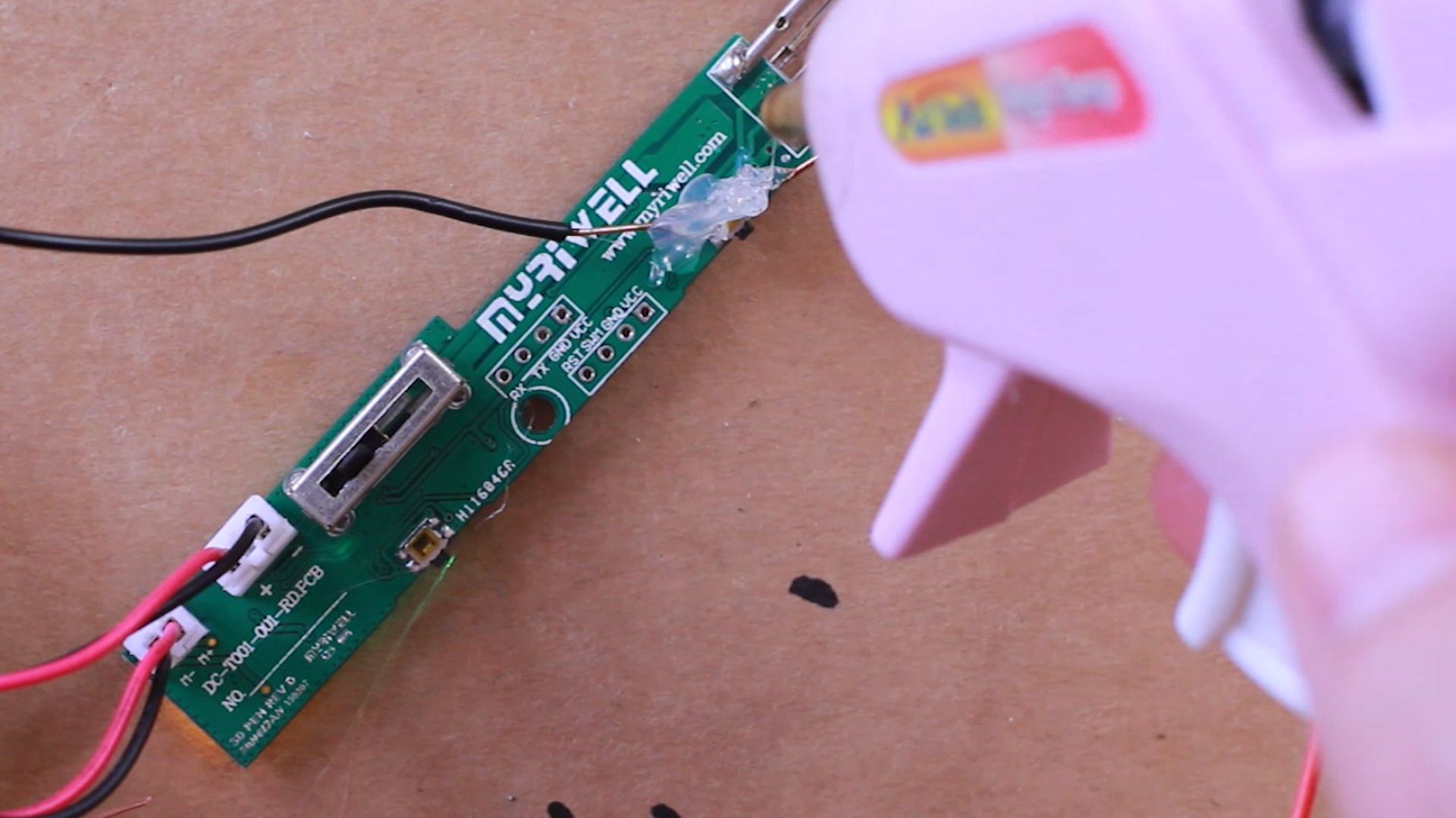

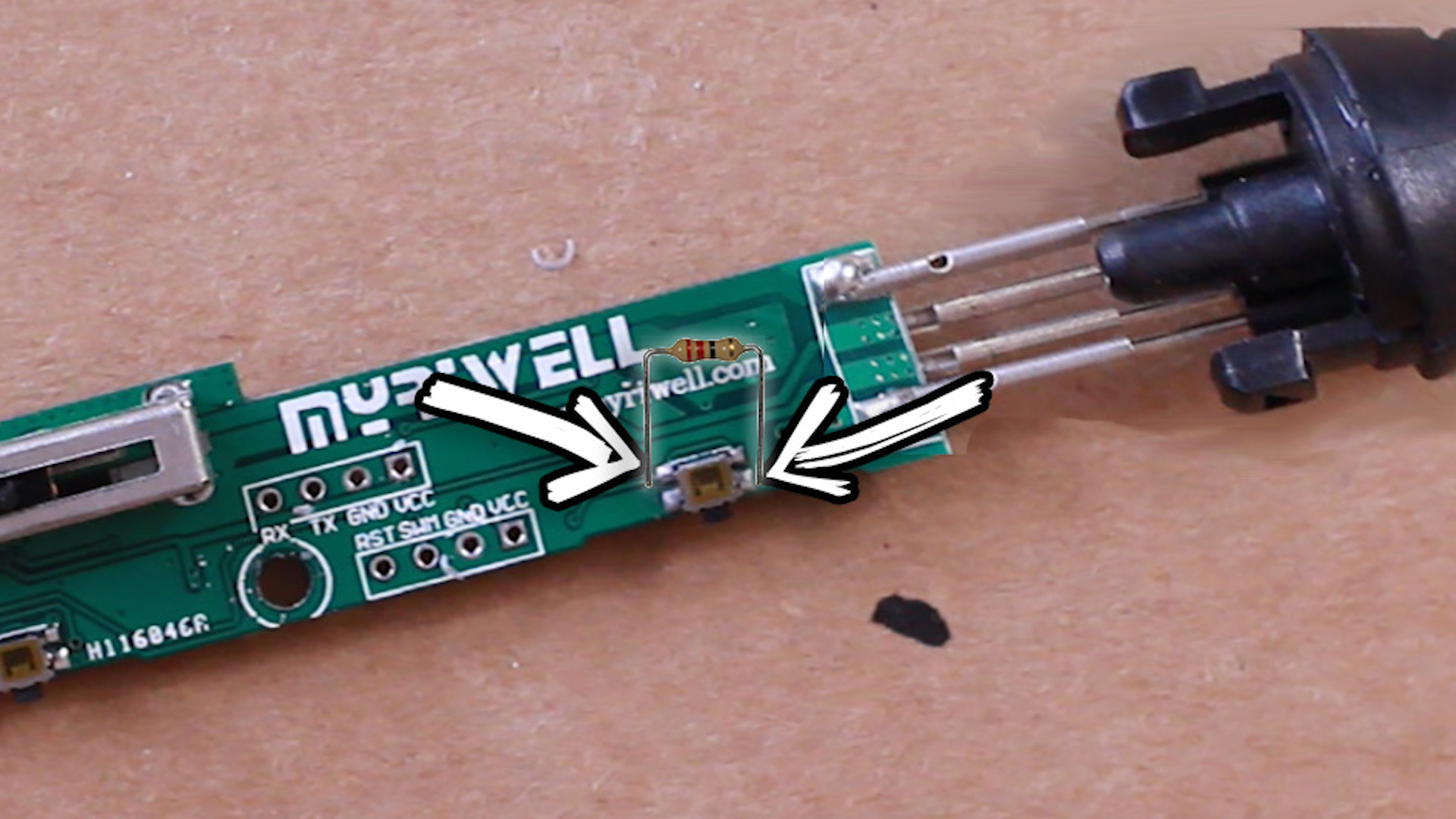

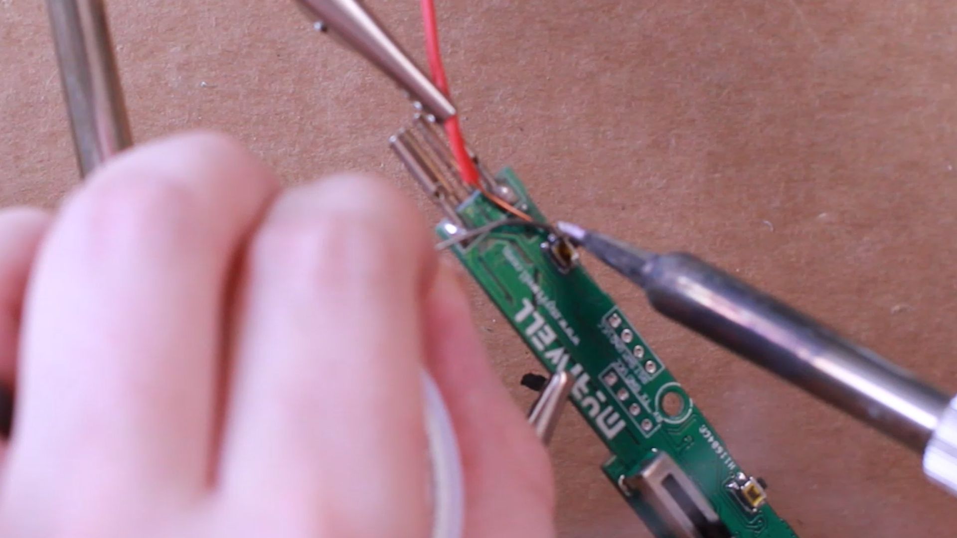

Once that’s done, you should see the forward extrusion button. It should have 4 leads coming out of it, one at each corner. We want to test to see which combination of leads trigger the motor. Before we can do this, however, we need to reconnect some parts: the hot end/nozle and the wiring to the power jack/motor insert. With those two items reconnected, you can power up the 3D pen. Once the heating element light is green, take a 1k Ohm resistor and touch one end to one of the leads, and the other end to another lead. Test each lead until you hear the extrusion motor start to spin. Once you’ve found a correct combination of button leads, the next step is to solder a wire to each lead. The leads are very tiny, so be careful not to use too much solder and end up getting solder all over components that you shouldn’t.
| Test The Leads | Solder Wire To The Leads |
Before re-assembing everything back together, touch the wires together using a 1k Ohm resistor to make sure that everything works and is soldered properly. And to make sure the connections don’t come unsoldered, a good trick is to put a dab of hot glue on each connection to hold them into place. And once you have the wires secured, you can start re-assembling the device. Using a drill or a knife, you can bore a small hole into the back panel of the device to make a place for the wires to run through.
| Hot Glue The Connections | Reassemble |

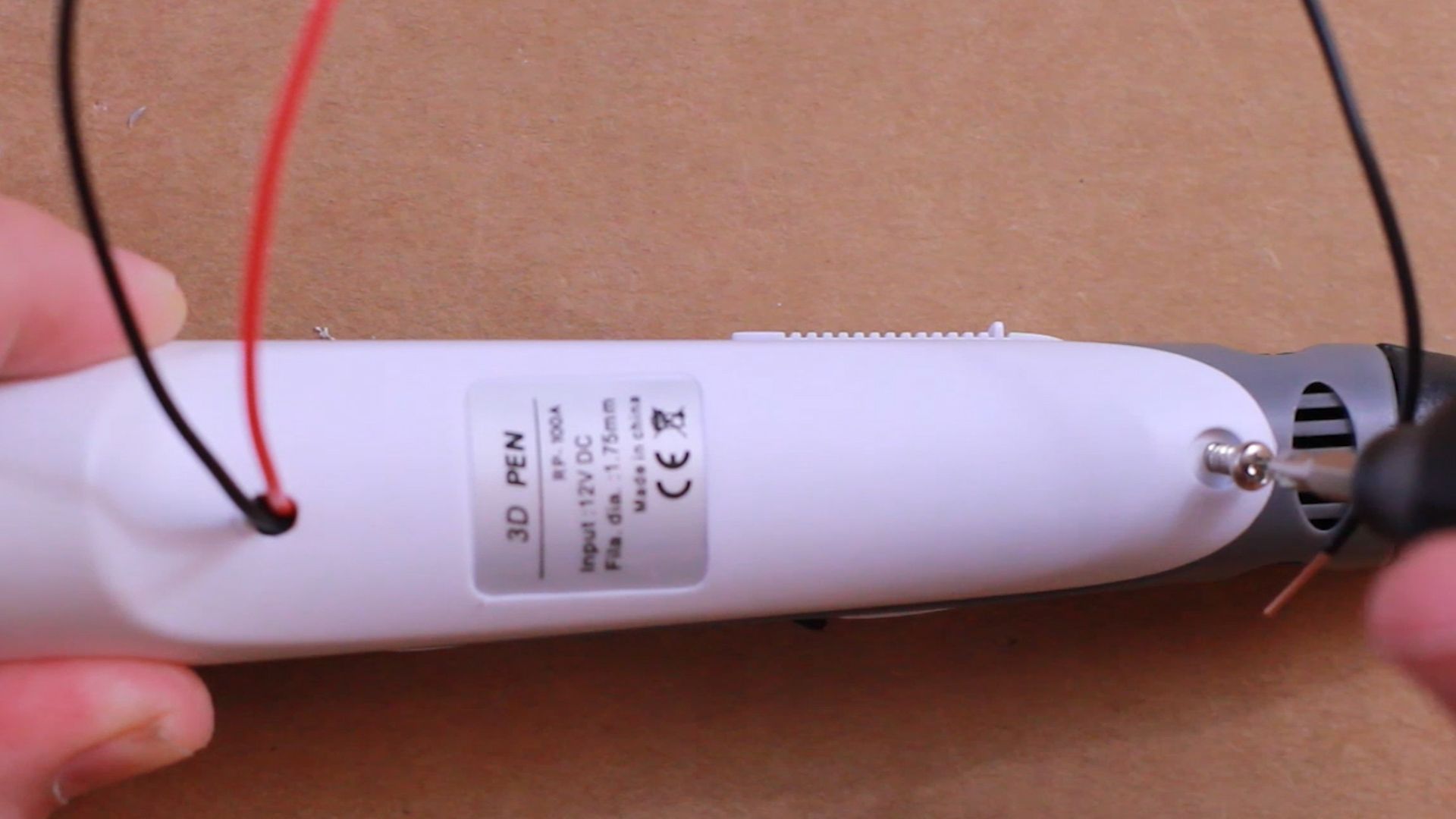

To determine what value resistor works best for your 3D pen and transistor, here are a few steps you can take. Start by connecting the pen to the emitter and collector pins on the transistor. Connect an Arduino ground pin to the collector pin on the transistor. At this point, go ahead and power up your 3D pen to start testing, but leave your Arduino powered off completely. Once your 3D pen is powered up and ready to go, take a wire and connect the base pin of the resistor to a ground pin on the Arduino. If this causes the switch on the 3D pen to turn on, that’s fine, it just means the resistance is too low. So now we need to start adding resistors. Start with a 1K ohm resistor and connect it from the Arduino ground to the transistor base pin. If the switch still turns on, try a 10k ohm resistor. If it continues to turn on, keep adding higher and higher resistors (ex. a 100k ohm resistor) until the switch no longer turns on.
Now we know what value of resistance will keep the switch off when it’s connected to ground. The next step is to determine what value will turn it back on when current is applied. So take the resistor that is running from the base pin to the Arduino ground wire and connect it to the Arduino 5v pin and power on the Arduino. If the switch does not turn on, that means the resistance is too high, so we need to start stepping down the resistor values. I jumped down at a 47kohm resistor, but it still didn’t switch on. After that, I tried a 22k Ohm resistor and it worked! So 22k ohm is a value that provides enough resistance to prevent ground from switching the transistor on, but will still allow a current to switch it on.

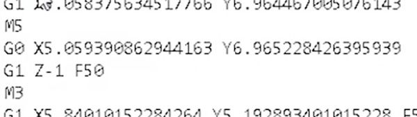

Before we can run this Gcode through GRBL Controller, we need to make a few edits to ensure that it works with our 3D printer. So open up the file that you saved from makercam.com in a text editor such as Notepad. You should see a bunch of different lines of letters and numbers. These are the GCode coordinates that are sent to the machine that tells it what to do. We want to add “M3” and “M5” commands to tell the filament extruder when to extrude and when to stop extruding. Here’s what you need to do:
- Below “G17” is the first “M3” command. Since this starts the extruder way too early (at the beginning of the script), we want to move it until after the nozzle has moved to its starting position, which is immediate after the first “F50” (feedrate 50) command on the next line.
- Throughout the rest of the code, everytime you see an “F50” command, place an “M3” command immediately after it on the next line.
- Next, look for the first Z0 command. Z0, moves the nozzle to 0mm, which we do not want. That would push it down to the base platform and ruin our print. Instead of moving the Z axis at this point, we want to just stop the extrusion motor. So everytime you see a Z0 command, delete it and replace it with an M5 command.
- At the very end of the script, after the final M5 command, we want to move the Z axis so that it is above our final print. Since I set my print height to be -1, I’m going to set the final Z axis height to be -2 (G0 Z-2)
- After setting the final Z height, a helpful thing to do would be to move the X and Y axis back to their original starting positions. So right below the Z axis movement, put “G0 X0 Y0” to move them.
Save your code and then your ready to print
| M3 & M5 Example | Ending Code Example |
