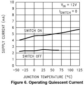

The main attraction of this component was it's quiescent current - the weather station operates on a tiny Arduino Nano most of the time which uses about 30mA with the sensors attached and powered up. It would be no good to me if the quiescent current was 50mA like with the dodgey gadget from China as that would be more than the device current. Looking at the datasheet, Bob has a quiescent current of about 5mA, which is totally acceptable.

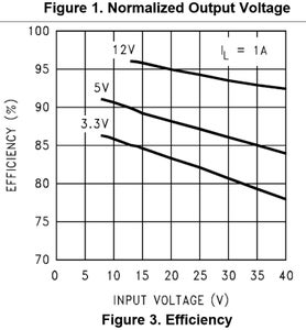

The other thing to look at is the actual efficiency under load. According to TI, it should be 90% when stepping down from 12V to 5V.

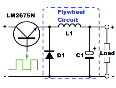

Bob creates a high frequency square wave pulse that creates an electromagnetic field in the inductor that effectively stores voltage that's then available to whatever load is applied. It is possible that the input to the inductor can go to values less than zero, so the diode is there to draw current from the ground rail.
Effectively, the circuit can operate like a kind of flywheel, depending on the operating frequency and the value of the inductor. The capacitor helps smooth out the voltage changes across the load - it can be noisy!
Bob is actually a bit more complicated than a simple transistor as shown in the diagram and has a feedback function from the load so that it can stabilise the voltage a bit better, but this only works properly if the feedback wires and resistors are kept well away from the inductor.

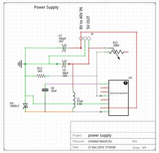

The good news is that the circuit is dead easy to build and requires no special skills. I used a piece of hackable prototyping board to build the permanent version for bolting into the weather station control panel.

The actual circuit is pretty much taken from the datasheet for Bob except that I have used a 1K resistor for the FB to ground connection and a variable 10K pot instead of the 3k resistor specified from the datasheet formulae.
PS. The LED is optional but should be easily removable as it will waste valuable energy during actual operation 'in the field'.
