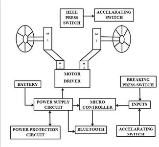

As shown in the image, there will be two boots with the a motor powered wheel and a dummy wheel in each boot.
  • The Battery powered and wifi enabled Galileo Board is fitted with the transmitter.
  • The Smartphone app developed specially for this sends the commands over the wifi and transmits the data to the corresponding motor by means of the receiver
  • Brake circuit is also included as a safety measure
  • The Motors are powered by the separate battery source in each shoe or boot

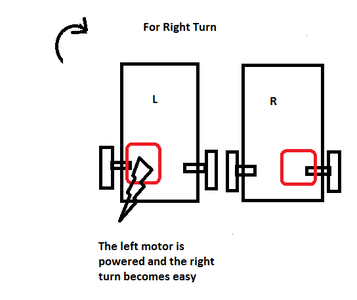

  • Right Button powers only the left sided shoe's motor and since the dummy wheel in the left part and 2 wheels in the Right foot are not powered, the result is a Right Turn

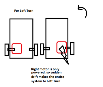

  • Similarily Left Button powers only the right sided shoe's motor and since the dummy wheel in the right part and 2 wheels in the left foot are not powered, the result is a Left Turn

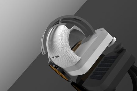

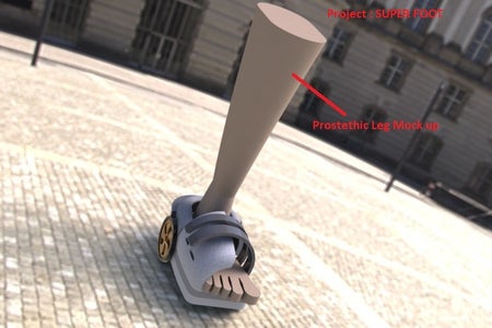

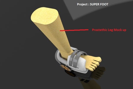

Attached are the renderings of the actual design.
