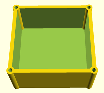

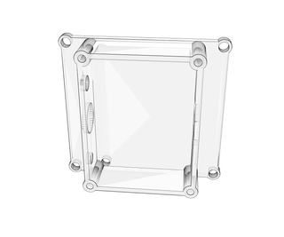

I stacked and staggered the cells and took a caliper to it. I used a harbor freight plastic caliper just to be safe. I could have made it a flat pack like the laptop but I wanted to be different.

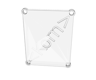

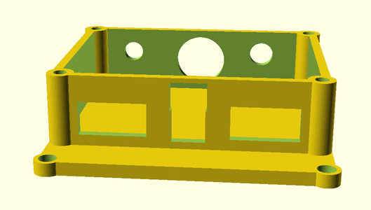

A quick box modeled in OpenScad and I had the start of a power cell. I made a flat lid and then added a slightly smaller box for the electronics.
