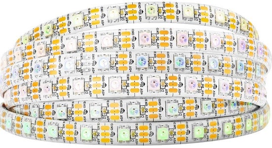

The next item you will need is the LEDs. These are a 16' strand of addressable LEDs that are 5v powered. 300 LEDs in all.

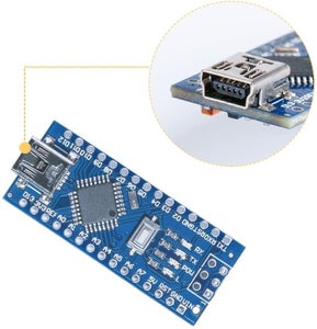

Finally, you will need a small microcontroller, a tube style battery, and a power converter (LM2596 DC to DC Buck Converter).
Step 1: Light Up Test
First thing we did was connect the LEDs to make sure they are working with our microcontroller. I used the very popular FastLED library to control the lights.
This is a fun step just to see all the lights, light up; especially if you use their 'ColorPalette' example.

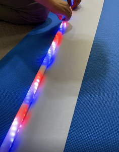

Step 2: Light Strand
Not ever building a lightsaber before, we took other's examples and wrapped the LEDs around a clear acrylic pole. The results were not exactly what we wanted, you could easily see all the LEDs and them spiraling around. There is an example included here that shows that.
So we undid that, and tried the second technique; just folding the LED strip in half.
Surprisingly, this produced a much better result. I would have bet the wrap method would have been better, and I would have lost!
So, for this step, we ran the lights the length of the 6' tube. Folded the end over on itself, and ran it all the way back to the start. There will be a bit of extra length that will need to be cut off.
Step 3: Wrap the Lights
To defuse the lights a little bit, we wrapped the LED strand in parchment paper. This was an inexpensive solution and gives a 'good' result. Not an awesome result, but good.
We found that life is much easier if you glue the strip down to the parchment paper, then wrap. Otherwise, the lights and the paper become disconnected and it is hard to align them again.

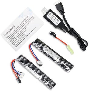

Step 6: Saber Power
I used an 11.1V battery that would fit into the handle. This battery is 2000mah, meaning it the lightsaber will last about 2 hours because the light strip pulls almost a full amp of power.
As you know, the lights and microcontroller only require 5V, so we need to attach this battery to a dc-dc converter to get the 11.1 down to 5v. I used a large converter because the constant 1amp current from the light makes this converter get hot! Like really hot, I measured the temperature to 200 degrees Fahrenheit!
Not hot enough to melt the PBA+ plastic but certainly hot enough to re-melt any hot glue you might have used.
Step 7: Microcontroller
Next we connected all the wires to the Arduino Nano. We used a single button to change the colors; just cycle through them. The code is here and it is very very simple. Perfect if this is your first experience with programming Arduinos.
