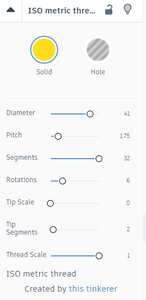

The half at the right will have the male thread of the box. To add it We'll select an "ISO Metric Thread" located in the first page of: SHAPE GENERATORS →Featured.
Sizing the Thread: Since the height of the complete box is 50mm, We'll size the thread 45mm so it doesn't go across the entire box . For the diameter it can be any number that doesn't exceed the size of the box. In my case I will use a diameter of 41mm. The rest of the thread parameters can be found detailed in the image above.
Thread must be centered to its half box in the X and Y axis. For the Z axis it should be raised 2.5mm from the workplane.
