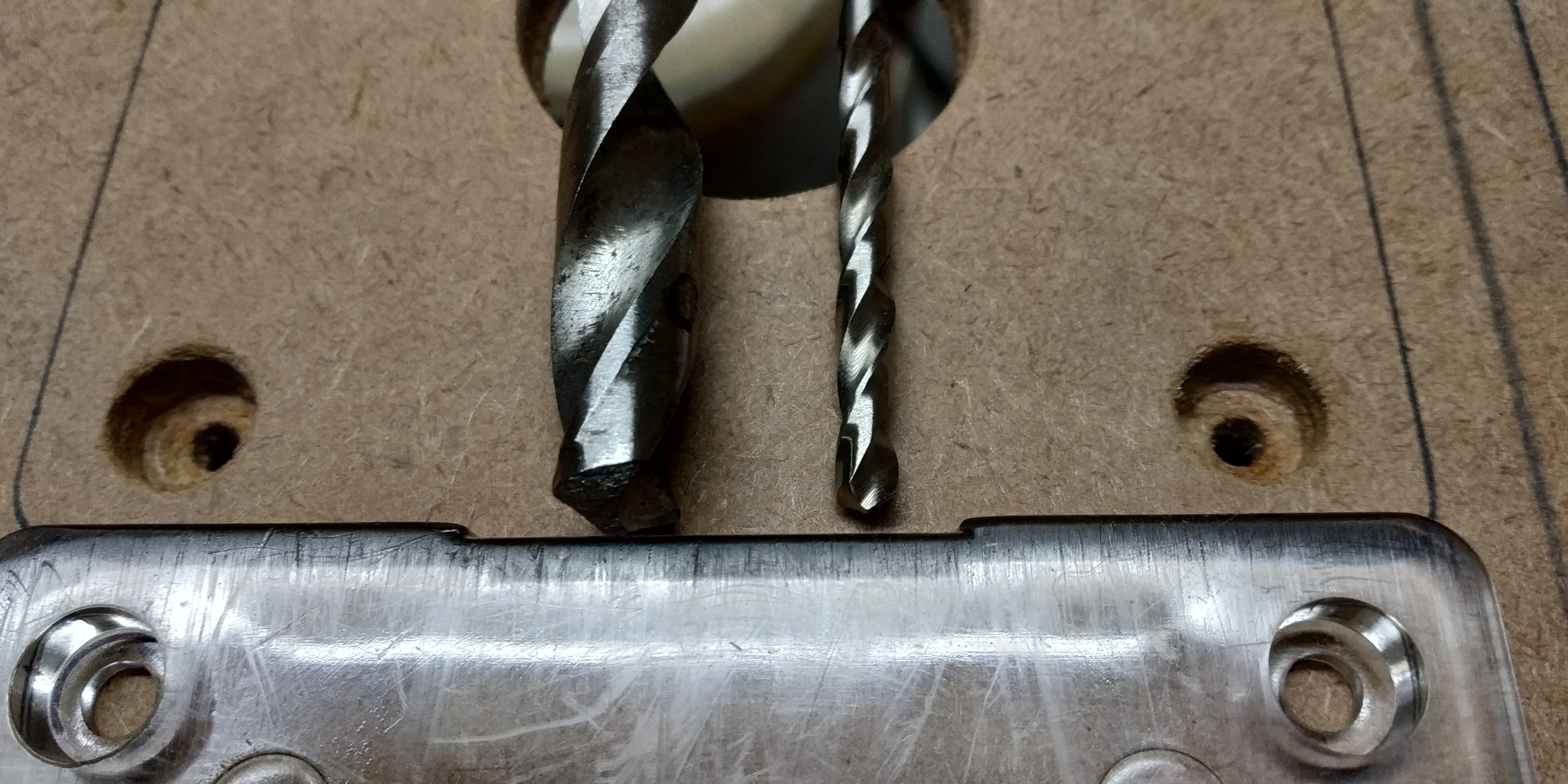

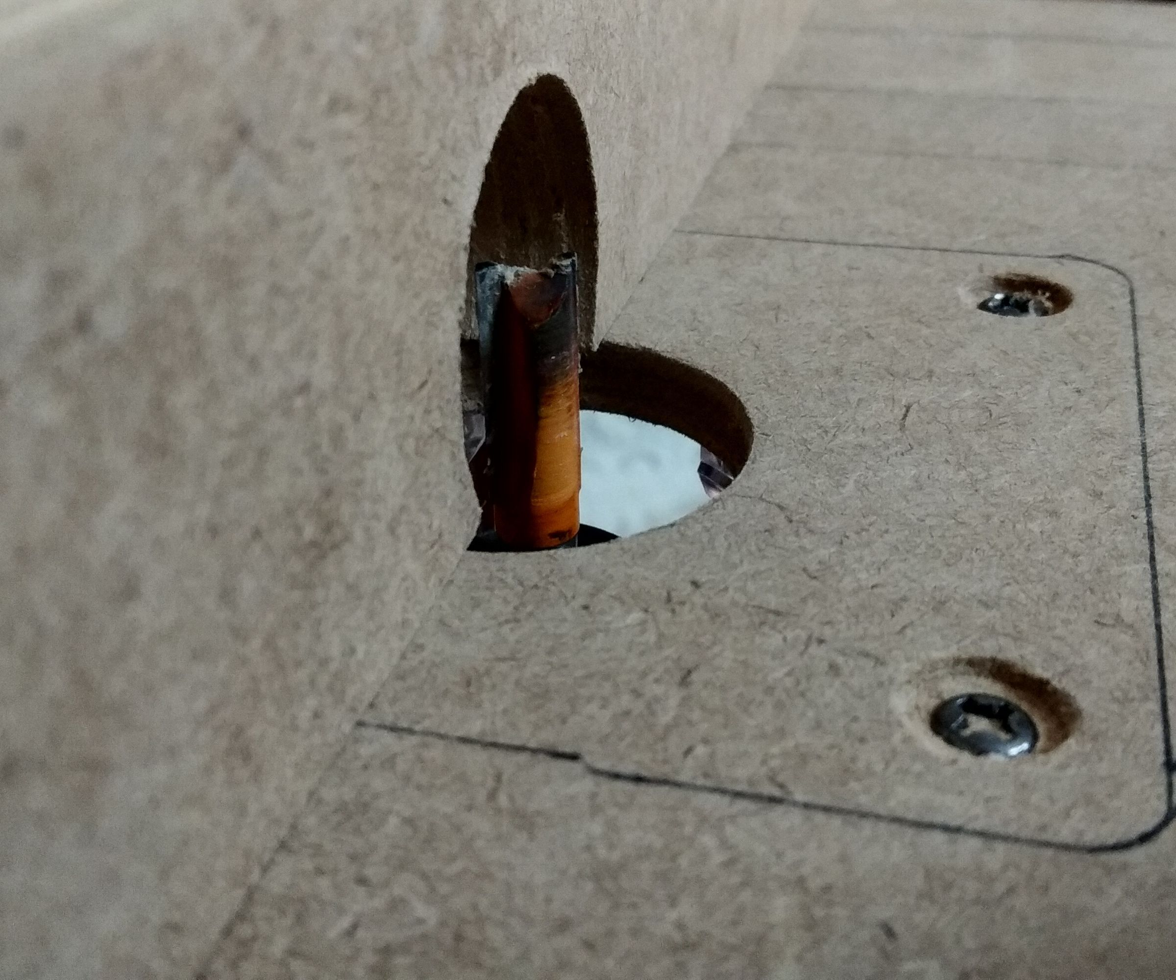

First I prepared front, back, left , right panels and then top & bottom. After cutting I flush trimmed all the edges using trim router on my handmade router table(check my previous instructable on a super easy trim router table).

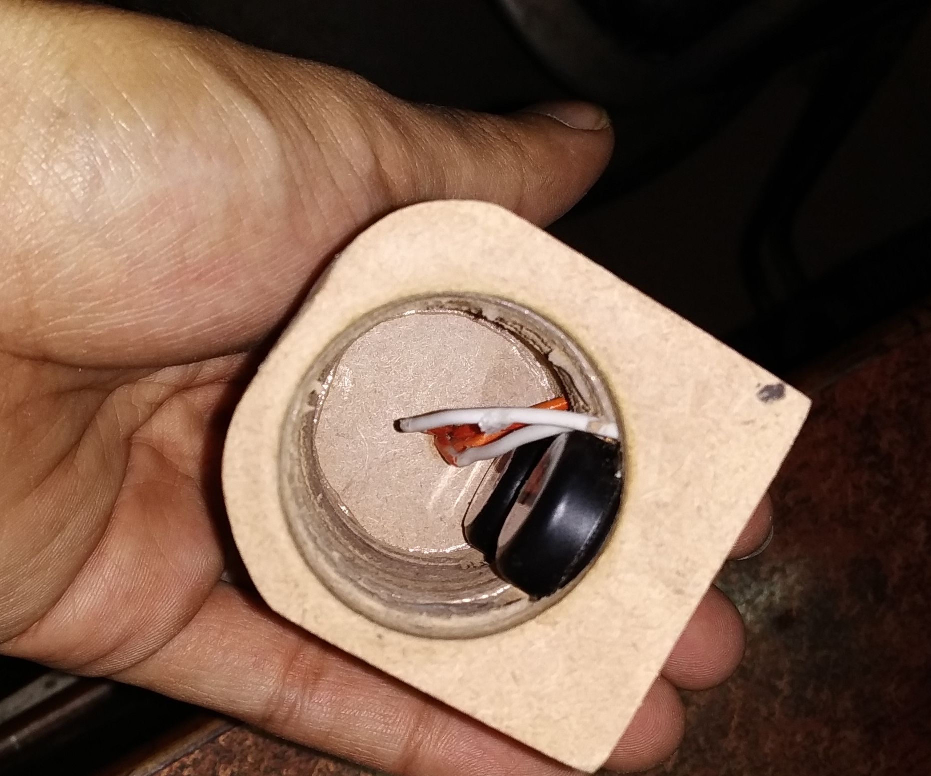

First I glued left & right panels to front panel and also marked holes for driver and radiators. After that I glued back panel as well and drilled the required holes. In fourth and fifth image you can see how the enclosure will look after full assembly. I also drilled a small hole in back panel that will make way for cables. Before next step I also glued bottom panel.
Step 3: Adding Drivers and Radiators.
I started with radiators and glued them up with fevibond. In third image I have applied hot glue to radiators that seals them properly. Before adding drivers I engraved out some space in front panel using my router that will keep our protection grill in place . In sixth image drivers have been added using fevibond again.
