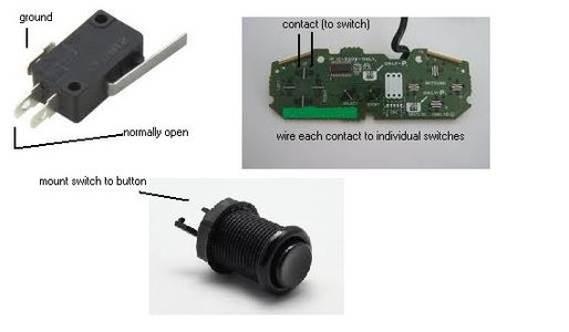

Controls - When you play a SNES or really any game console with a controller where you push a button it makes a contact to complete a circuit which is rendered and controls an action in the game. So you can just rewire that contact's 2 terminals  to an arcade button's included switch with the normally open and ground terminals of the switch, essentially your using the original controller just modified for arcade contacts. Arcade buttons and supplies can usually be obtained through local or online arcade hobbyist retailers.
