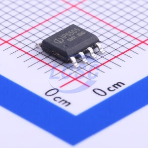

The IP6505, a step-down converter with an inbuilt synchronous switch that can handle an output of up to 10A for fast charging protocols, is the project's main appeal.
An integrated power MOSFET with an output voltage range of 3V to 12V and an input voltage range of 10.5V to 28V is a feature of the IP6505. By automatically altering the voltage and current in accordance with the recognized rapid charge protocol, it can produce up to 24W of output power.
Typical output configurations include 3V@3A, 5V@3A, 7V@3A, 9V@2.5A, and 12V@2A.
The IP6505 features CV/CC characteristics: in CV mode, the output voltage remains constant when the output current is below a set value; in CC mode, the output voltage decreases when the output current exceeds the set value.
It also has a line compensation function, which increases the output voltage as the output current rises to offset the voltage drop caused by the connecting line’s impedance. The IP6505 includes a soft start function to prevent input power instability due to inrush current during startup.
It supports various fast charging protocols, automatically identifying the protocol supported by the connected device via DP/DM and adjusting the output voltage and current accordingly.
Supported protocols include DCP (Apple, Samsung, and BC1.2), Qualcomm QC2.0/QC3.0, Huawei FCP/SCP, and Spreadtrum SFCP. The IP6505 also offers multiple protection features, including input overvoltage and undervoltage protection, output overcurrent, overvoltage, undervoltage, and short circuit protection.
The buck conversion efficiency reaches up to 97.5%.You can checkout its Datasheet here: https://robu.in/wp-content/uploads/2020/06/USB-Fast-Charging-Module.pdf

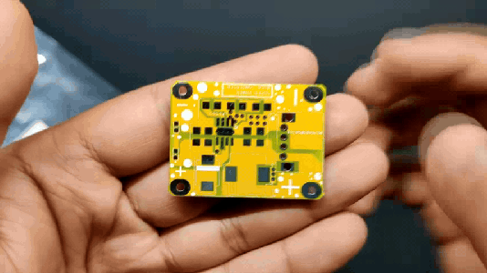

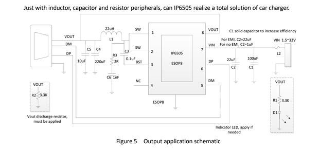

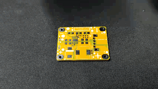

We created an initial layout using the IP6505 datasheet as a guide. It included a few resistors and capacitors linked to the IP6505 in the suggested setup.
In order to create an ALL-SURFACE-MOUNT board that can be utilized as a module in an upcoming project, we employed all SMD components in this case. To put it simply, the user can add this board as a surface-mount device to another PCB by utilizing SMD.
Following the creation of the board schematic, we moved on to the PCB design. This included creating a 40 mm by 30 mm board with input terminals on one side and USB on the other. According to the specification, the IP6505 is positioned in the center, and the input and output capacitors are positioned as close to the IP6505 as possible.
Step 3: PCBWAY SERVICE
Following the completion of the board design, we ordered a yellow solder mask with white silkscreen and submitted the PCB's Gerber data on the PCBWAY quote page.
PCBs were received within a week, and the PCB quality was outstanding. Here, we added a few design elements on the board's silkscreen layer to increase the aesthetic appeal of the project. PCBWAY made the custom layer properly, which shows their great PCB manufacturing capabilities.

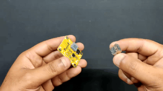

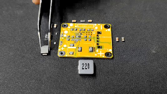

Step 4: PCB ASSEMBLY PROCESS

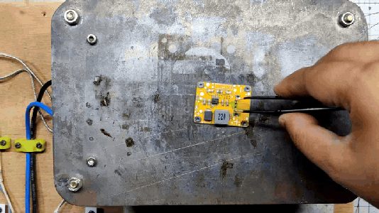

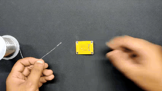

- Using a solder paste dispensing needle, we first add solder paste to each component pad, one by one. We're using standard 37/63 solder paste here.
- Next, we pick and place all the SMD components in their places on the PCB using an ESD tweezer.
- With extreme caution, we lifted the complete circuit board and placed it on the SMT hotplate, which increases the PCB's temperature to the point at which the solder paste melts and all of the components are connected to their pads.
- Next, we added the Through Hole USB Port in place and then soldered its pads from the bottom side of the circuit using a soldering iron.
The circuit is now completed.

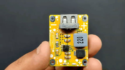

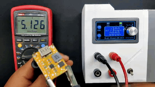

Step 5: RESULT
The result of the PCB Assembly process is this power module, which can provide a consistent output between 3 and 12 volts, depending on the source.

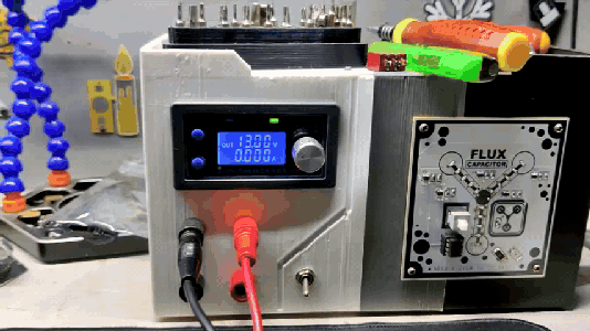

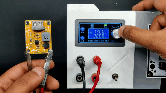

To Test this Board, we first connected it with our previous DIY Bench Power supply, which you can checkout from here-
https://www.hackster.io/Arnov_Sharma_makes/diy-bench-power-supply-6f32d3
We gave the power module 13V by connecting the bench power supply's alligator clips to the module's input terminals. We connected our multimeter to the output side, and the result showed 5.1V, indicating that the setup was successful. When several PD-using devices are connected, the output voltage will vary.

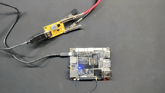

After that, we attached a LattePanda Version 1 to the power module's output via a USB cable, and the device powered up as anticipated.

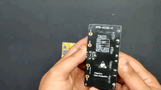

The power module is operating as intended. The primary goal of this project was to create a tiny power module that resembled the MH-KC-24 power module that I had previously used in another project.
https://www.hackster.io/Arnov_Sharma_makes/battery-box-version-1-274d45
Since this module was bulky and difficult to use while working on a small project, we made our own module with the same IC but a smaller form factor.
