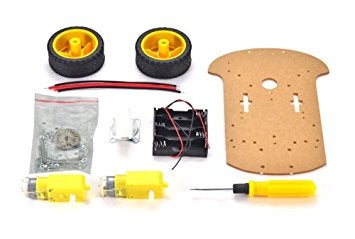

Materials:
Motor Robot Car Chassis Kit with DC Motors
M3 nut and bolt
In addition you will need the following tools:
screwdriver
Tape

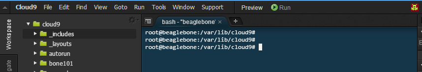

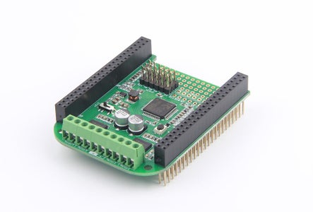

Insert the Motor Bridge Cape to BBGW, power Motor Bridge Cape with 9-12V Battery. Then plug in BBGW via USB, connect it to Wi-Fi and open the Cloud9 IDE.
Here is the guides:
http://wiki.seeed.cc/BeagleBone_Green_Wireless/#getting-started
After that, we will start an new terminal in Cloud9 IDE.

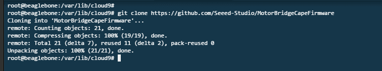

Download the code from Github:
git clone <a href="https://github.com/Seeed-Studio/MotorBridgeCapeFirmware"> https://github.com/Seeed-Studio/MotorBridgeCapeFi...</a>
Navigate to “MotorBridgeCapeFirmware” and execute “make flash” command to flash the firmware
cd MotorBridgeCapeFirmware/ && make flash
After a few seconds, you can see “Verification OK” information from the terminal Check if the firmware is flash well by execute following command

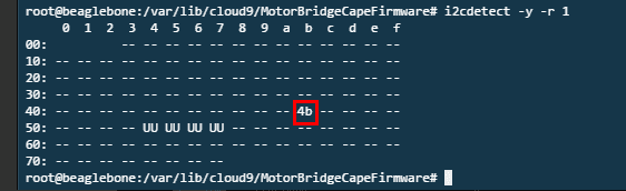

i2cdetect -y -r 2
And If you can’t find the I2C address 0x4b, be sure that the P9_23 Pin is High, since the P9_23 is connect to Reset pin of STM32.

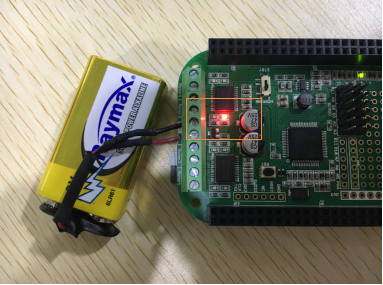

Step 5: Test Motor Bridge Cape
Then please download the Motor Bridge Cape Driver Library from Github for a test.
cd /var/lib/cloud9<br>git clone https://github.com/Seeed-Studio/MotorBridgeCapeforBBG_BBB.git cd MotorBridgeCapeforBBG_BBB cp BBG_MotorBridgeCape/MotorBridge.py tests cd tests python DCMotorTest.py
If you can see the the red led and blue led of motor3 flashing in turn, it means that the Motor Bridge Cape works well.

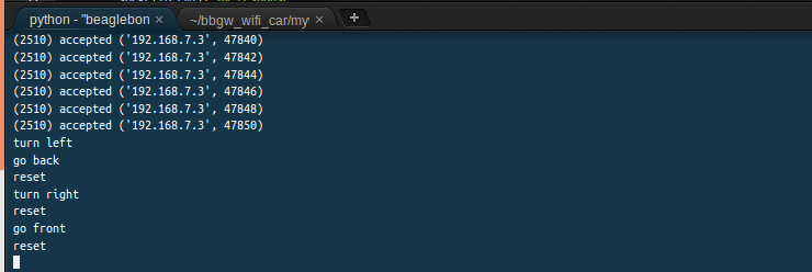

Then type 192.168.7.2:5000 or [your BBGW ip addrees]:5000 in your browser to visit the remote control website.
Click the button to check if the web socket works well(each of your click will be printed in the terminal).

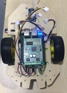

Now it is time for assembling your Web RC Car! Power off the BBGW and Motor Bridge Cape, fix them on the top of chassis with tape or screw(here it is my upgraded Web RC Car in the picture with a DIY chassis and some grove modules, if you want to make one coooool chassis for your car, there is a CDR file attached at the following step).
And don’t forget to connect the DC motors to the cape. The motor on the left is connected to port 1 and the right motor is connected to port 4. I attach the battery at the back of the chassis and power the cape with a adapter and 2 jumper wire. After that, power the cape first and still plug in BBGW via USB. Open Cloud9 IDE again and run app.py. We are going to check out that if the motors works as we expect. All the action of the motors are defined in “mywificar.py”. If I need my car go straight on, I will turn the right wheel clockwise and turn the left wheel counterclockwise at the same speed, as the “goFront()” function. When you click the up arrow button in the website and the car doesn’t go straight--just circles, then you have to press the stop button and switch 2 wires in port 1 or port 4. Besides, “PwmDutyRight” and “PwmDutyLeft” are positively associated to the speed of the motor, try to increase them for a faster speed. After debugging, just rip out the USB and place your Web RC Car on the ground. Connect your phone to the Wi-Fi named “BeagleBone 05xxxxx” and visit 192.168.8.1:5000. Congratulation! Please enjoy the fun of DIY!

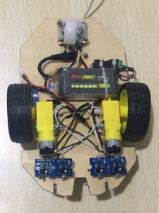

Next, I am going to extent patrol mode for the car and make a cool chassis for it. For the patrol mode, we need 4 Grove - Line Finder sensor to recognize the trace, a Grove - Switch for mode selection, Grove - Chainable RGB LED for mode show(Red means patrol mode and green means RC mode) and Grove Base Cape for connection.
Grove Base Cape for Beaglebone v2.0
The code is in folder “mywificar_v1.1”. Please confirm all the Grove modules are connected to the right port as what I mark in “mylinefinder.py”, “myled.py” and “myswitch.py”.

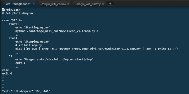

Step 10: Set Auto Run
For convenience, we can set the program auto run when BBGW boot up. After that, we don’t have to plug in BBGW via USB and type command line in terminal.
Now create a file named “mycar” in /etc/init.d
cd /etc/init.d
vim mycar
//press “i” to insert in VIM and copy the following code#!/bin/bash
# /etc/init.d/mycar case "$1" in start) echo "Starting mycar" python /root/bbgw_wifi_car/mywificar_v1.1/app.py & ;; stop) echo "Stopping mycar" # killall app.py kill $(ps aux | grep -m 1 'python /root/bbgw_wifi_car/mywificar_v1.1/app.py' | awk '{ print $2 }') ;; *) echo "Usage: sudo /etc/init.d/mycar start|stop" exit 1 ;; esac exit 0
Next,
sudo chmod +x /etc/init.d/mycar sudo service mycar startsudo update-rc.d mycar defaults
Now “/root/bbgw_wifi_car/mywificar_v1.1/app.py” will start automatically when BBGW boot up. What's more, you can start or stop this program with the following commands:
/etc/init.d/mycar stop

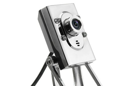

Step 11: Extend Web Camera Video Streaming
Now I am working at video streaming on BBGW. I manage to transmit a real time video on our remote control website. That must be more interesting and exciting! We will be able to explore this world with a whole new vision.
Mjpg-streamer is my choice, but there is an unstable delay when video streaming. If you have some good ideas or if you are interested in this, please don’t hesitate to let me know! Just post your comments! Thank you!
