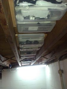

Instead of one continuous track I broke mine into sections that would hold 2 containers with enough space on either side to slide it over and take it down. That way I would only need to move the container I wanted to access.

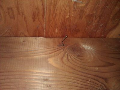

Since this is a basement project more than likely you will have nails or staples poking through the ceiling. Removal is very simple hit them with a hammer bending it over about half way. Then hit it back to other way and it will probably snap off.

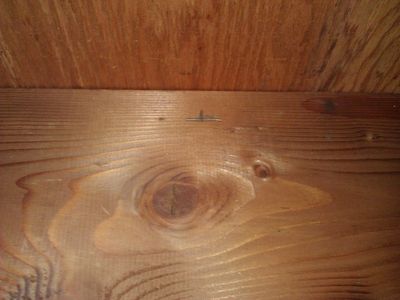

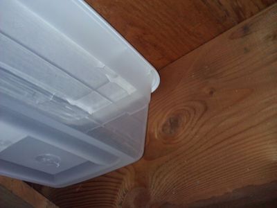

Next we need to find how high we can mount the container so put it up to the into the space and mark the bottom of the lip(pic 2). Use a measuring tape, measuring from the ceiling down to the mark and add about 1/4" just for space. Mark about every four feet with the value we just came to and mark both joists(pic 3). If you are working by yourself put a nail at the beginning on one side of the row and use a chalk line to snap an even line the length of the joist. Then repeat the process for the other joist.

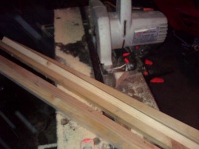

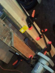

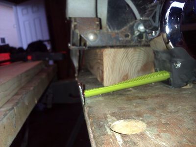

If you are like me and don't have a table saw you can make a jig. I used a B&D workmate but any bench will do. I used a scrap piece of 2x6 to elevate my saw above the table and to work as a guide for my cut measuring Ht away from the opening in my bench. Then set the circular saw on top with the blade next to the benchtop. Clamp everything nice and secure a either tie the trigger on the circular saw or use one of your hands. Begin cutting just like you would with a tablesaw including using push sticks so you dont lose and fingers especially when you get close to the end.
Now you have a nice pile of evenly cut hangers all thats left is to crosscut them at H intervals and all of the hangers will be ready.

Use either screws or nails to secure the hangers. Make sure you set the top of the hangers at the line NOT the bottom. Then fill and hang the containers and you now have easily accessible storage that is out of the way.
