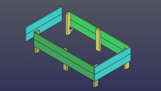

I asked the store to cut the wood for me. For this 3'x5' bed I need 4 times of 1"x6"x8' and 1 time of 2"x4"x10' for the posts. I cut the posts longer so they can be buried into the ground and keep them stable. You can also modify the plan for 2'x6' for example with the same amount of material. You will need some wood screws also.
As you can see in the cut list, we will use almost all the wood, nothing wasted

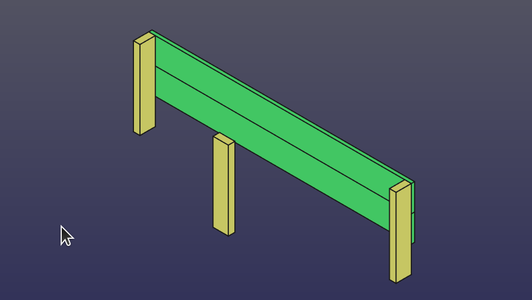

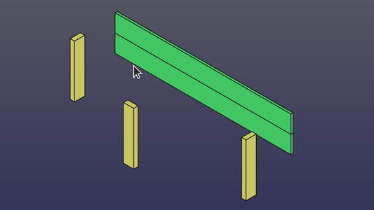

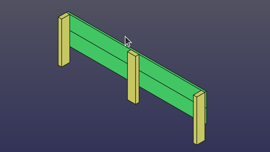

Step 1: Assemble the Long Sides
Then we can assemble the long side of the bed. We will need 2 green boards of 1"x6"x5' and 3 posts for each side. Predrill holes will save the wood from cracking. Reinforced post will be put in the middle of the long side.

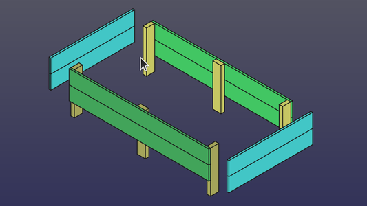

Step 2: Attach the Short Sides
Mount the 2 cyan boards of 1"x6"x3' on each ends of the long sides to form a rectangle bed.
