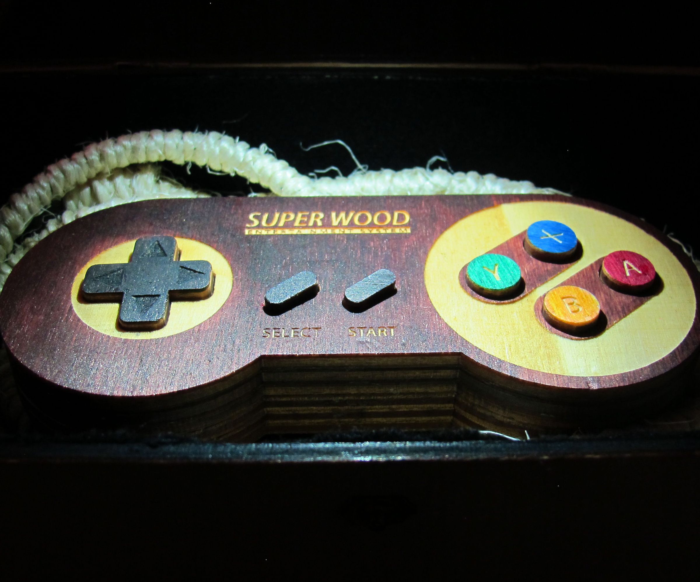

I proudly present my fully working wooden Super Nintendo Entertainment Systems. Before I posted my manual how to build a wooden Super Nintendo Gamepad and now it is time to show you how to build the console. The wooden case is made out of multiple sheets of plywood, stacked and glued together. In the following steps I will show you how to prepare the files for lasercutting, what electronics you need, how to join everything and how to glaze and finish the console.

In the end I was very happy with the result of the Super Wood Entertainment System. I discarded the other solution, but maybe some of you will give it a try! Now the Super Wood Entertainment System is complete, the gamepad and the console. The full joy of wood and retro gaming! There is a wireless gamepad in the making. I will upload some picture when it is ready!
