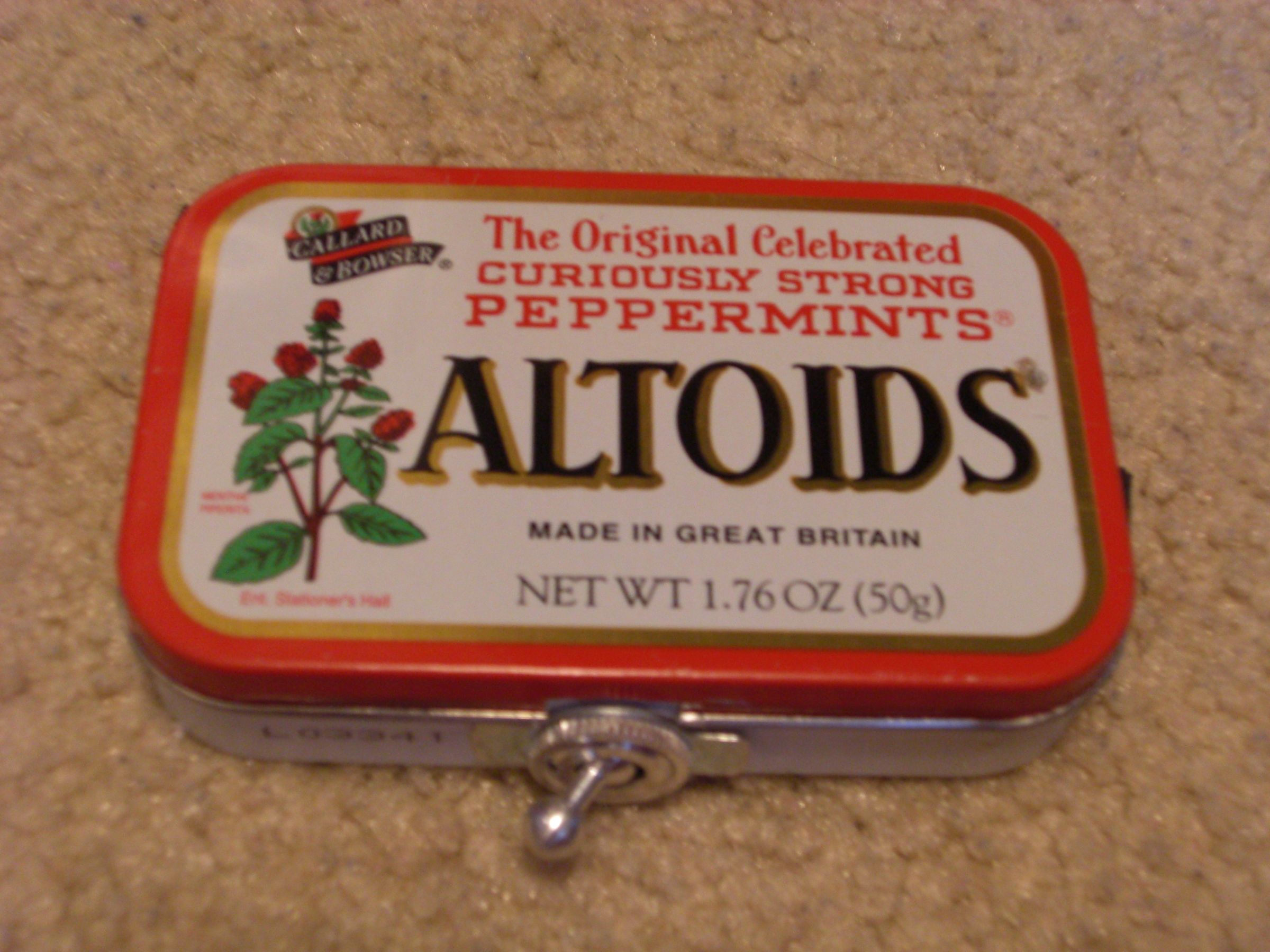

Step 3: Switch Design
Next i decided to find a place to put the switch.
It fits nicely where the screw holes were so i decided to put it there.
For this step you will need a dremel to cut the plastic so the switch will fit.
You will also need a drill to make the switch fit in the hole.
You will want to drill a small hole somewhere to put a wire tie in
The picture should show were i cut.
