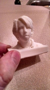

Step 7: Import Your STL Into 123 Design by Autodesk to Make a Base
You have a nice scan of a head, but it wont stand up on its own.
You need to put a base on it. Using 123 Design lets it simple and add a rectangle to the bottom using the Primitives > Box menu.
You can later add text like in one of my scans.
I am not going to get into detail on how to use 123Design but its a very user friendly app with lots of videos on how to use.
Here are some Tutorial videos.
http://www.123dapp.com/howto/design
Also on youtube many others have made their own videos.
When complete export the STL for the next step of printing.

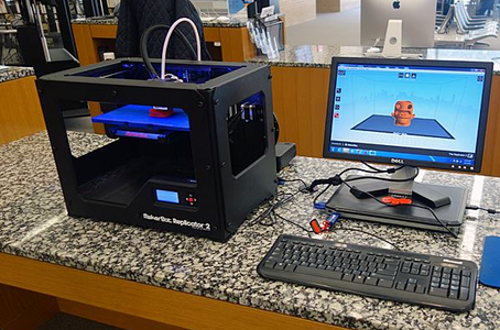

Option 3: I do not have a 3D printer and I do not want to spend any money on a print and would like it for free.
Many people do not know but there are a number of local libraries that now have 3D Printers and offer free print time each month. In fact there are 250 of them around the USA. There is often someone there to help you learn.
http://www.publiclibraries.com/
http://3dprint.com/40170/library-3d-printing-servi...
