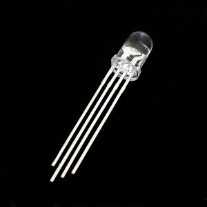

- RGB LED (I used THIS ONE)

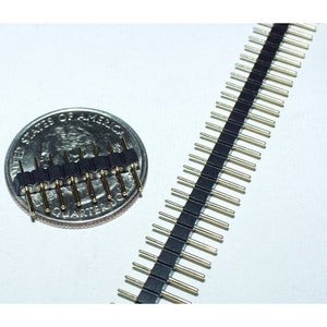

- Male header pins (I used THESE)

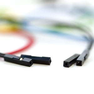

- Sparkfun connector wires (or any other wires that have crimped, plastic-housed, female connectors on both ends). I used THESE.

The Emic TTS module is a little big to just insert straight into the breadboard, and the pins on it are not at a right angle, so it will stick out and look ugly of you just pop it on the breadboard. So we will mount it on the back of the carrier board, and use the female-to-female hookup cables to hook it into the breadboard. Use an anti-static bag to keep the Emic TTS module in so that the circuit on the module won't short circuit itself/ the carrier board (or both) when piggybacking under the carrier board. Bring the hookup wire around and insert an 8-pin header row onto the breadboard, and then the hookup wires onto the header pins. Lastly, secure the TTS module to the carrier board with two rubber bands. We will worry about the connections in the next step.

- RED goes to pin9
- BLUE goes to pin8
- GREEN goes to pin7
- The common anode (+; it's the longest lead) connects to a 200ohm resistor, which goes to +5V (VCC)
